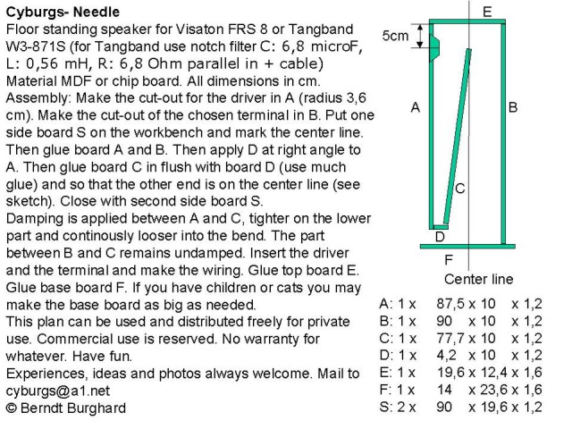

Hi there,
im willing to try my hand on building some DIY speakers, and theese seem to be a nice, good sounding and cheap enough to start with (as seen on youtube and reading comments). I can get Tang Band's W3-871B. Can some one point to the building plans for the Needle tower? Looks like everyting here is so old its not working anymore (pics of plans).
Here are the plans. Great speaker by the way!
Mike

Built a pair of theese bautys for my parents (tv and light music use). Still amazed how good the bass response of the 3" drivers are. Driven off Sureelectronics 2x100w apm (one of the first versions) and keep loving those tiny speakers.

I'm a newbie speaker builder who would appreciate some advice. Also please forgive me if my project seems like an exercise in overkill--kind of the opposite of the usual DIY ethic of using as little as possible to get the best results possible. I would like to build the Needles according to the plans at SPLIBS, using baltic birch plywood, as my office system, running from a DIY mod/rebuild Dynaco ST-70 that I'm already committed to.
The Tang Band driver that many people have used is the W3-871SC 3" (Parts Express listing and specs), which is now apparently discontinued. I would replace it with the W3-1878 3" bamboo (Parts Express listing and specs -- and also further description here) -- unless someone can suggest a driver that is better sounding or significantly more efficient (for possible later use with SET). I've searched and a few people on the web seem to have tried this combination, but there are no details.
Are the specs of the w3-1878 close enough to those of the w3-871 that I could use the plans as-is, other than just adjusting the size of the driver cut-out? Or is there some simple mod (different port size? taller box? wider? etc.) that would make it work better?
Also, would I likely need a notch filter? Could someone explain how to wire and install one?

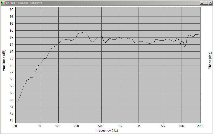

I traced the spl of the W3-871 (tangbands 100db scale makes it look smoother) but even on a 50db scale I can't see anywhere where you would be putting a notch, other than maybe 250 Hz which would probably be impractical, unless you were thinking above 12Khz??
I've no experience with this driver or the Cyburg needles though so take this with a grain of salt 😉
Tony.
