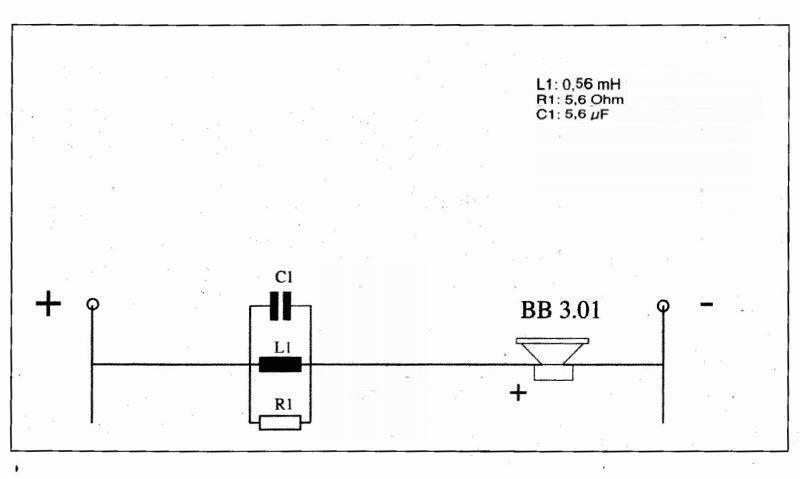

The alpair 6 is too expensive for me. The Omnes is much better than the TB or it is very similar? Can i use the Omnes with the original needles plan or i have to change it?

The actual build of the box is exactly the same. The notch filter may be a difference ... (Detail: The Omnes drivers don't need the notch filter as much as the TB W3-871 drivers do, so you can skip it. If you want a notch filter then you need different values ... HenkJan of juoiga.nl posted a filter for the Omnes somewhere around here.)
Better and worth the extra money in my opinion. Better and more bass, clearer sound, and less harshness.
See specs of Omnes Audio BB3.01 and suggested notch filter
View attachment bb301.pdf

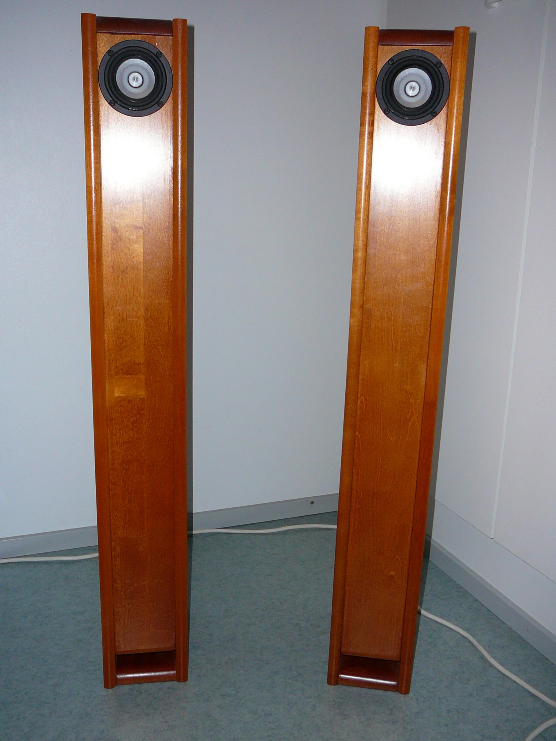

All my speakers are raw MDF
Ever since i built and lovingly veneered and finished my first speakers...which were Bass reflex boxes for the TB W3-871s I have not finished a box nicely. Concentrate on sound first then finish them after all the tweaking...or move on and scrap an MDF box that you have little investment in. But you learned something about fine woodwork! Think of the positives!
I built two of these and it was the biggest dissapointment of my speaker building life. All I had at the time was a 20$ hand plane. I used some beautifuls timbers double layered and sanded inside and out to perfection. It took me a month and ended up ruining my carpal tunnel on my one remaining good wrist. I have a plate in place of the other. They just dont go loud enough for me unless I lived in a toilet maybe. And they sound so thin notch filter or no notch filter. YMMV. Of course they will suit some but I feel compelled to warn peeps like me. I wish somebody had warned me. I was so disenchanted I never finished a speaker to that quality ever again. Well I never felt my finger tips again lol. I would much rather have any vintage $50 phillips dual cone in a small refex box scabbed from a opshop. With out a notch filter! Its not put me off tqwt though Iam considering a bib currently.
