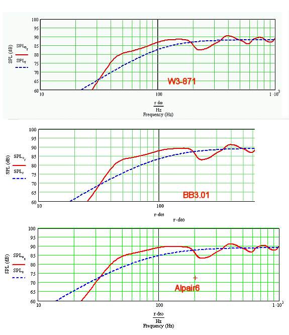

dude, this will never fit in a Needle... the Needle cab is only 12cm wide, this driver is 13cm....
Errr ... which is why I said in my first post in this thread (about 8 posts up) that I increased the cabinet width from 10cm (internal) till 13cm ...
Maybe there is some misscommunication between us. 🙂
If the Needles are a small fullranger in a low tuned Mass loaded transmission line, then I just want to adjust the Needle to a SPH-60x.
Semantics aside, I modeled the Needle with the TB W3 and it didn't look as good as with the SPH-60x, so I was hoping on some second opinion.
Sorry for the confusion ...
Cordraconis said:Errr ... which is why I said in my first post in this thread (about 8 posts up) that I increased the cabinet width from 10cm (internal) till 13cm ...
What you are talking about then is designing a new TL based on the Needles folding. It is no longer a Needle.

Henkjan: Thanks! Quite a difference with what I/Hornresp expected. Hmmm ... seems I will have to take a look at MJK's software then.
During googleing I came across some dutch sites and I see now that it was your site they sometimes referred to. Small world. 😉
Planet10: Thanks for clearing this out. Feel free to move everything from my first post on, to a separate thread if you consider this necessarily.
I remembered that one of the alternative drivers for the Cyburgs Needle was a 6" driver, hence why I tought these designs were still named after the Needles. Now that I looked it up, I found it was the Markaudio Alpair 6, which is 4" wide, contradictory to its name. 🙄

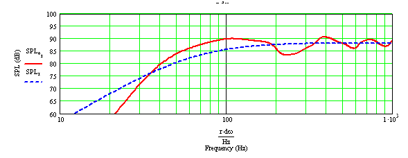

if you post the TSP I can run them through a sim, so you
ll get at least a feel for the low end

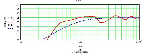

Dear Henkjan,
Many thanks for the offer for the Dynavox FR88EX.
These are the details from the Spectrum Audio site;
88 mm Breitbandlautsprecher,
95-32000 Hz Übertragungsbereich,
84,3 dB Kennschalldruck,
25 mm UH-Schwingspule,
15 Watt belastbar,
2,27 Gramm bewegte Masse,
Aluminium-Membran ,
Gummi-Sicke, Leichtmetallgusskorb, Neodynmagnet,
Nennimpedanz/Gleichstromwiderstand: 8/6,0 Ohm
Resonanzfrequenz: 95 Hz
Gütefaktoren(Qms/Qes/Qts): 1,96 / 0,62 / 0,47
Äquivalenzvolumen(Vas): 1,27 Liter
Effektive Membranfläche(Sd): 27,34 cm²
Antriebsfaktor(BL): 3,31 Tm
Schwingspulenüberhang(Xmax): 3 mm
Schwingspuleninduktivität(Le): 0,045 mH
Kind regards - Jem

Ok.. when I get home...
@gaust: I'll need an Sd to do the sim. btw: a 4" will not fit in a Needle..
Dear Henkjan,
Thnaks very much for doing that and for posting the previous results for the other drivers.
I agree it does look OK 🙂
