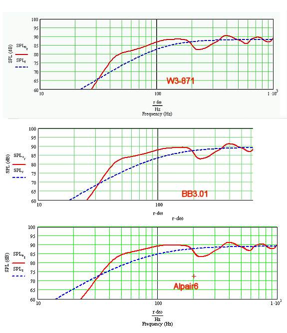

HornResp model of Needles
A friend of mine was looking for some reasonably cheap sound in her small dorm room and since I have a pair of Monacor SPH-60X fullrangers gathering dust for over 4 years, I offered to "see what I can do". (A simple and not too powerfull second-hand amplifier can be found on the internets for under 50€, bringing the whole project at around 100€.)
Since I have some experience with HornResp and it can model unstuffed/undampend Mass-Loaded Transmission Lines, I first simulated Cyburgs Needle with the Tangband W3-871S parameters I found on the PDF-specsheet. After choosing the Combined response option in the FR plot, I got a huge dip between 50-100Hz, not to mention the spike around 45Hz ... I am pretty sure I modeled it right, but somehow i think this is not the way the needles are supposed to sound.
I then adjusted the width of the cabineth from 10cm --> 13cm (i.e. increase the cross-sectional areas by 30%) to fit the larger Monacor SPH-60x and planned to adjust the model untill I got a FR plot that looked acceptable. Strangely enough, I got a perfect plot from the first time! Compare this to the plot of the TB W3 needles ...
I never expected the SPH-60x to be a drop-in replacement (with width adjustment), so what is going on here?
To simulate stuffing somewhat, I increased the length of the 2 large conical sections/folds and then it goes deeper with a gradual slope that can fit room gain to some extent, as is expected, so i think the problem is not in HornResp but in the parameters.
What is wrong with my TB W3-871S simulation? And if that would be ok, what does this say about the validity of the SPH-60x simulation?
I feel like I'm missing something here ... any second opinions?
Aside from AkAbak - which fits HornResp for equivalent models anyway - I don't have other modeling programs that can do a ML-TL, but maybe someone can do a quick comparison? Thanks in advance!

Asides from the measured FR graph from Cyburgs himself somewhere on the first page in this thread, i found this simulation with a few different drivers.
http://www.coolcat.dk/bjoern/needle_analysis.pdf
Both lack the spike-and-dip on the bottom of the graph and I haven't found much comments about uneven freq response. Off course about the lack of bass, but with these drivers this should be much less of a problem than with the smaller ones they use.
Hornresp and most other modeling software usually exaggerate high Q peaks, but even with some dampening I think this is too much to smooth out.
If I would go ahead with it, I will definately post results here, but for now I am a bit wary and i can wait a few more days to see if some interesting remarks pop up around here. 🙂
here are a few....
Thanks Henkjan, I have seen more flat curves now than the one I have of the Needles, so the problem definately lies with my simulation.
I see you have made different simulations with various drivers. As I don't have the opportunity to install or use this spreadsheets, would you mind plugging in the parameters for the SPH-60x (with the increased cabinet width) to see how it models? I suspect the FR curve will be mostly the same, but the low end is even more raised than with the other smaller drivers.
thanks in advance/dank bij voorbaat!
