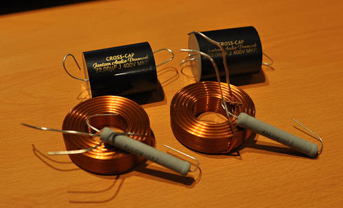

I can't wait either! Drivers are on their way, in the meantime I'm drooling over the first set of decent filter components I've ever had...
