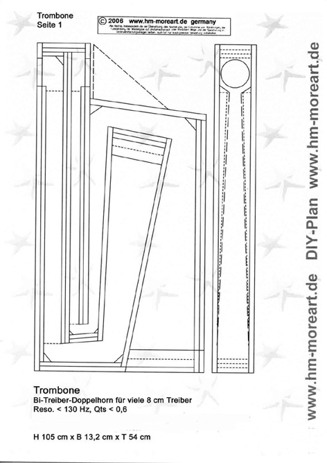

Hello HM,
Without a doubt your horns produce more sound as they take more material to built them. Your motto less is more made my wife laughing when she had a look at your designs. 😀

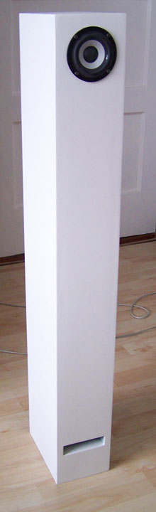

Just showing off my Needles(See atachment), build them with the Tangband w3-315SC the notch filter is kept outside the speaker.
The speakers sound very nice and detailed. You really can hear it's been made from brushed aluminium. Without the notch filter they're a bit harsh.
I've kept to the origional design, and added a chamber underneath for sandfilling. Painted them white (my first white speakers!). Actually I painted them black first, but I didn't like the color: white's more elegant.
Needles do look very good in white, Henri. I also like the proportions that the sand-chamber give to the box - in your version, the port looks more balanced in proportion to the whole speaker.
Congrats, and enjoy! Have you heard the Needle with different drivers, could you give a comparison?
