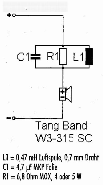

finally got the notch filter in mine. everyone was right, huge improvement.
before - short listening periods, even at low volumes, caused my ears to be strained.
after - listened to them for good half hour on low volume with now issues of fatigue. turned them up for quite a while and jammed out and still had no issues.
as stated before, im still new to the whole design concepts. could someone point me to a website or give me lil explanation as to how the inductor, resistor, and cap work together to make a notch filter. and also as to which freq range this notch filter is actually affecting. thanks. 😱
The inductor lets low frequencies through, the cap lets high frequencies through. Selecting their inductance and capacitance values, they block or impede a certain part of the spectrum - creating a notch. The resistor basically determines how 'deep' the valley is, if I understand this correctly. I'm electronics-naive, though.
I wish I had an URL to give you 🙂
This calculator shows you approximately attenuation (loss of power) at various frequencies, given certain component values:
http://lautsprechershop.de/tools/t_ps_schwingkreis_en.htm
The other day, I snagged the Javascript behind that form to see how the calculation works, and found that the center of the dip is around 2600Hz IIRC. I don't remember the exact decibel cut.

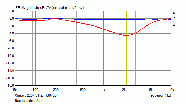

Here is the measured effect of the Needle filter with the W3-871S. Electric attenuation at speaker terminals:
Svein.

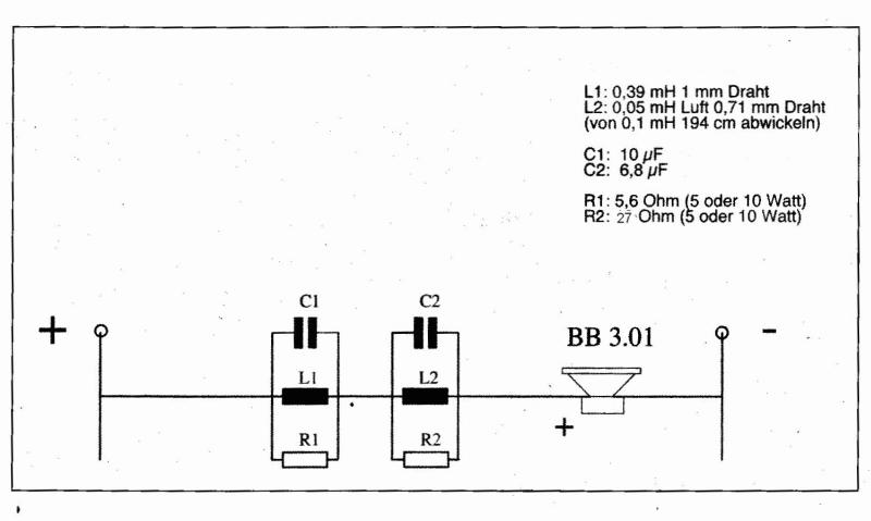

Zigis said:
What kind of notch filters you use with BB3.01, same as with Tangband or different ?
different, the BB3 is 4ohm and has different Qe and Le.
you could try either of the following:
C1 5,6 uF, R1 5,6 Ohm, L1 0,56 mH
or the one in the attachment, where the C2,L2,R2 is optional for a sometimes observed spike at ~9kHz (I have mine with this notch without the optional bit)
