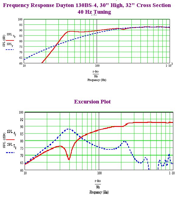

what about the 4 ohm version of the dayton 130BS? even higher sensitivity, plus would draw more power from amp to prevent TB from overpowering again?
So either of the BS daytons will work fine in a MLTL 30 high 32 inch cross section? Thats like 4.5 x 7.125 right?

I'll try the silver one tomorrow. As well as the Audax. But the Thiele-Small numbers seem to work well with these two.

I'll be doing the sim for the silver speaker right now. Got Martin J King's software all fired up. Should be posting the sim in half an hour or so.

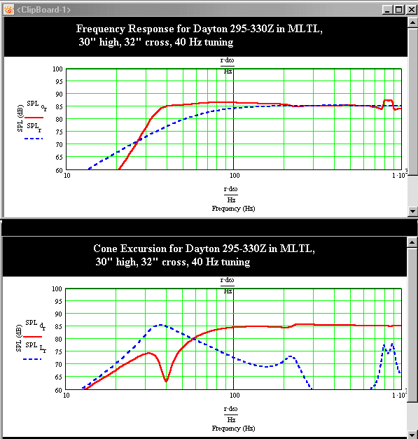

Okay, here is the aluminum coned Dayton, same enclosure. This one goes even lower than 40 Hz. The curve is not perfect, but it sure looks close enough. It is an 8 ohmer, not a four, so the TangBand will be playing at a similar SPL output. However, the TangBand will be drawing twice as much power.
Sreten seems to have some advice on Baffle Step Compensation which would fit better with a more efficient driver. So you might want to consider that in your driver selection.
The same box seems to work for three different drivers. We might be onto a winner here, lol.
