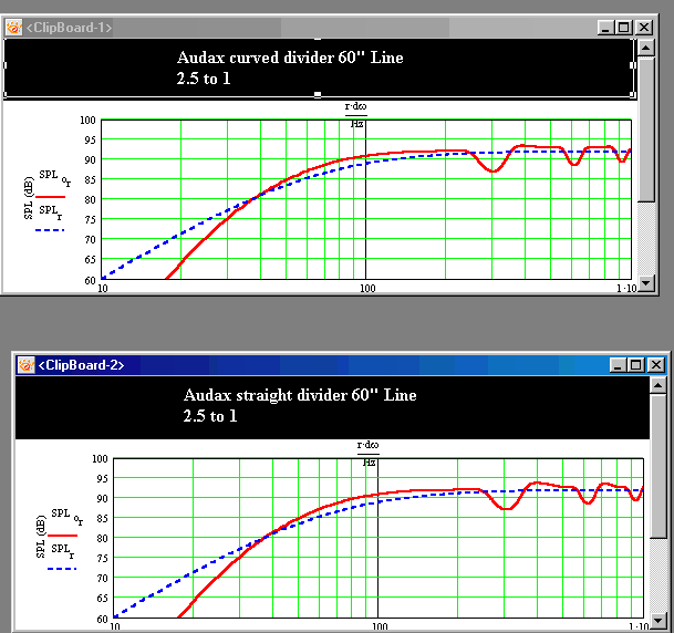

Here is a couple of TL designs, but they are almost a cubic foot volume.
I had much smoother response from a Daline of the same size, but the program froze on me before I had the chance to copy the response.
And as an alternative, we have the Mass Loaded Transmission Line, with a smoother response but with a 24 dB/octave cutoff. Which is not bad, but some like gradual slopes.

Sorry about missing the sim last night. Kind of tired.
Will be doing some sims tonight. Having some trouble getting smooth response from a normal TL. If someone else wants to try, that would be fine.
Daline is better, and I suspect Mass Loaded Transmission Line is even smoother, although I have yet to sim it.
See you later. I think sreten's driver has the best Thiele-Small parameters for whichever enclosure we use, so I'll sim that.

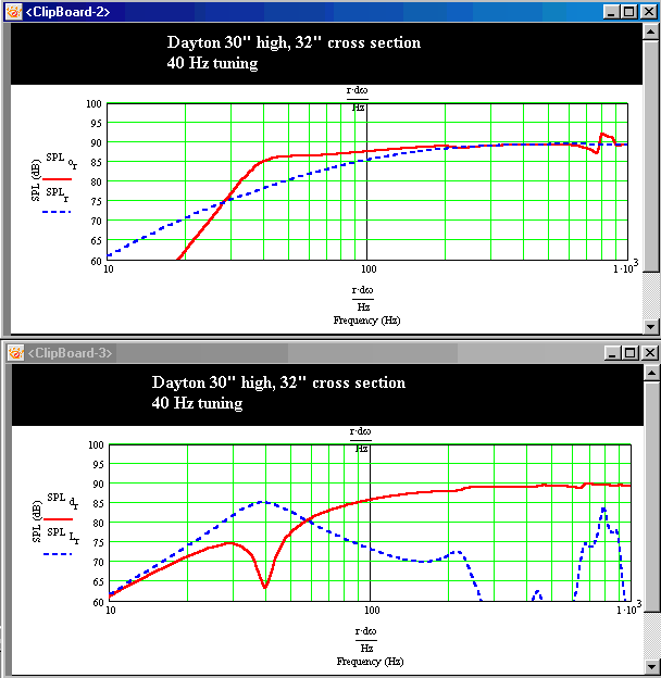

Sreten's Dayton
Well, I decided to stop messing around with conventional Tl's and Dalines. I went straight for the Mass Loaded TL, because Sreten's Dayotn has a small excursion, 2.5 mm.
The MLTL gives great excursion relief-the cone has to move less air than in the simple ported box. This unit is 22 dB down at resonance-in a ported box it would be only 12 dB down.
Here is a frequency response curve, here also is an excursion graph.
The MLTL is 30" high, 32" cross section area. Tuning is 40 Hz. the port is 2" diameter-I recommend you get a flared one. The port length is 7 inches.

That is the black Dayton, #295-301.
I'll check the other Dayton tomorrow.
As far as getting a lower response, I would just say that bass output depends on the amount of air moved. The MLTL enclosure apparently allows SPL output far hgher than a 5" cone normally will permit. But you are stil dealing with a 5" driver.
40 Hz from a 5" driver would be really, really good.
