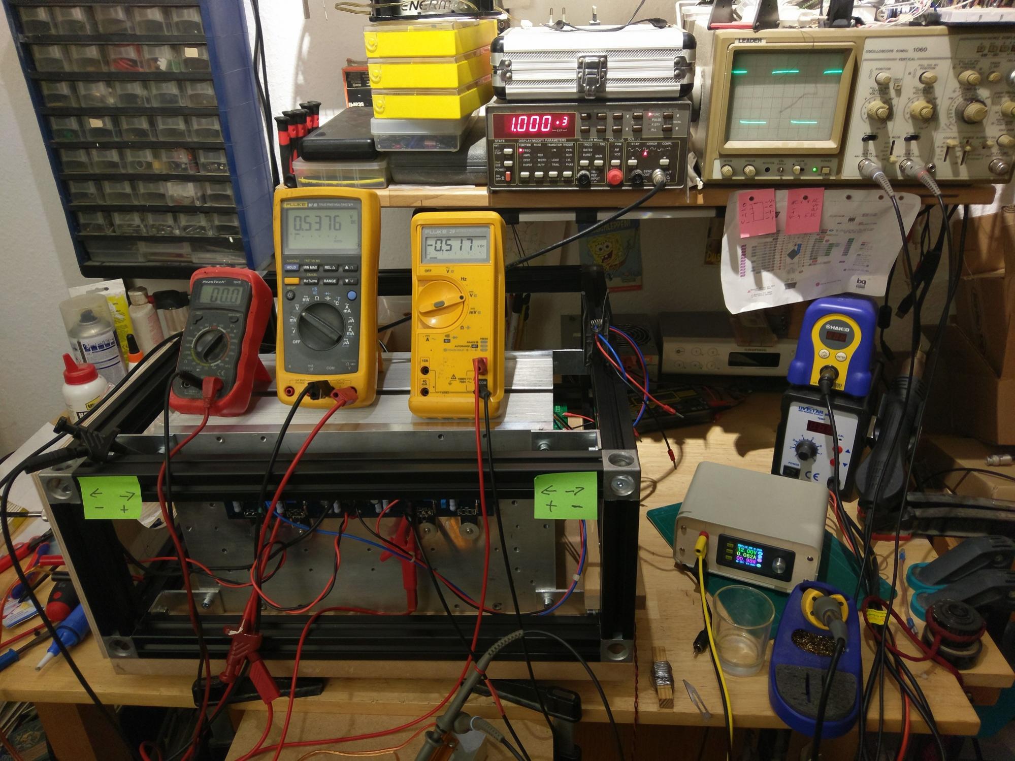

Yes, i think there were other issues too, especially since removing the current limiting circuit did change things. I also changed the BC560C in the cascode when i rremoved them to check for errors. The new one might have smaller GM and that culd have solved the issue, we dont know. The other is channel working fine (have to check again tomorrow) with currrent limiting still in place, so the BC560C is still a suspect to possibly have caused the trouble. However there is still some difference in Vgs. Maybe we are already down to acceptable levels, i wouldnt mind some feedback on this.
Nic, no worries you will get your hands on the fets as soon as i have some replacements and have confrmed we have a matching error. There is other possibilities that need to be investigated first: Two N-Channel fets got mixed up between channels, that could have happened too. You have a curve tracer, right, otherwise the other fets would not match up that precisely.
I measured them out of circuit using a constant current source at various currents ranging from 5ma to 700ma. I wont rely on my low current measurements, in the "high" current measurements up at 700ma the Vgs difference is 0.125V. i think the other fets are matched way better.
There is also the possibility that the source resistors dont match. But i tested these with terminal measurement and the mismatch between the voltages is slightly non linear.

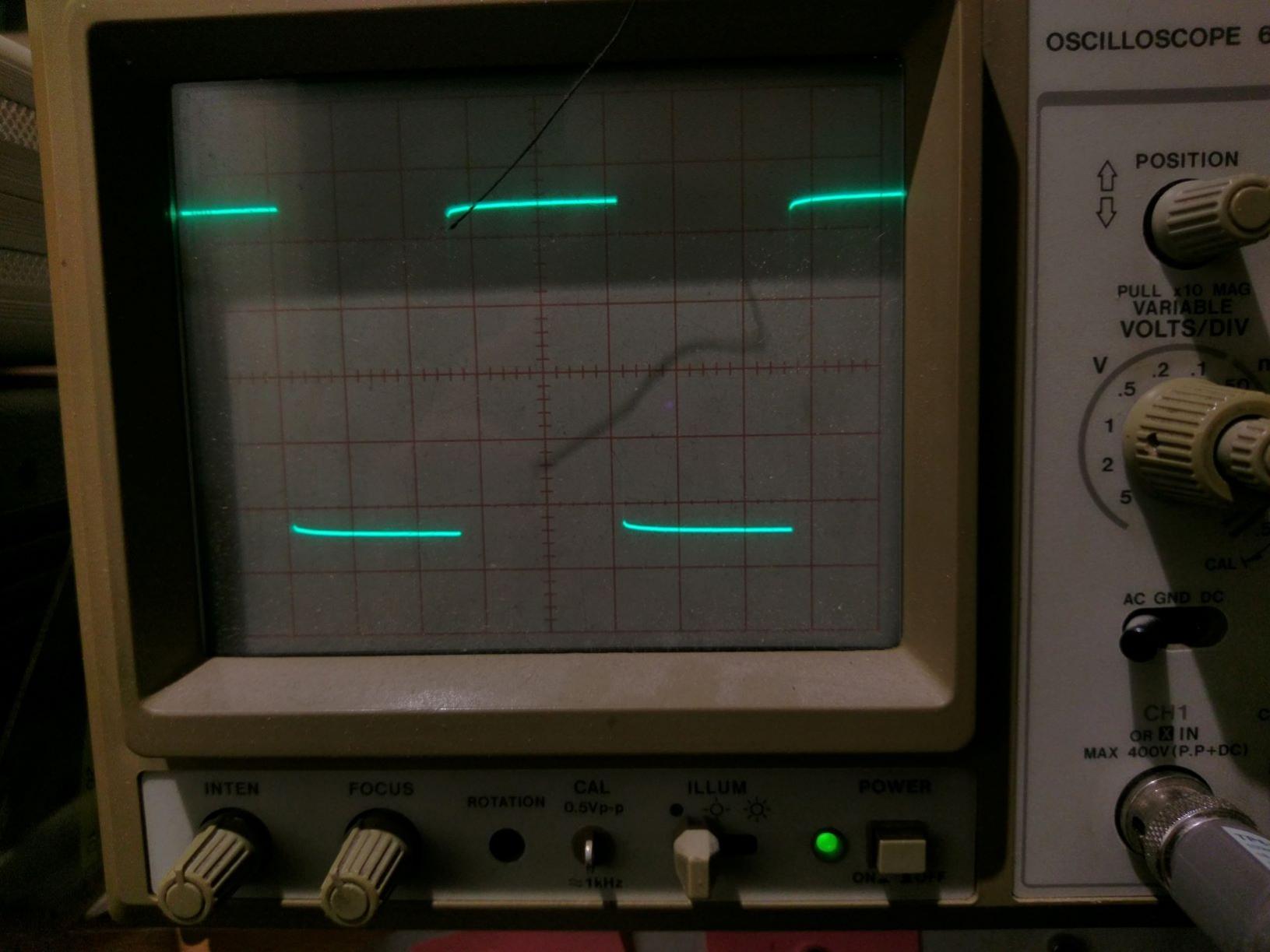

I didnt do much today, just checked the square wave response, 1kHz square wave at 1V out in 8 ohms dummy load, looks good, no signs of overshoot. I will take care of tthe other channel tomorrrow (remove current limiting circuitry and check / adjust bias)) , then some more burn in ... maybe even a listening test
Sounds like you are ready to start listening - at least on some test speakers.

Yes today was the big day. I hooked up both channels to 8 ohm dummys and my external soundcard to set P3 settings were done at 2.6V RMS. I use baudline for all my spectral analysis, sometimes JAA, i miss a log x axis but it does the job well.
Both channels are absolutely identical in THD S/N etc. THD is -86.5dB. Gain difference between channels is 0.05db. I hooked up the amp to my small desktop speakers, no turn on hump no noise no nothing, just music. Nice. So i hooked eveything up to my living room speakers (JBL TI5000). Oh boy, whats that fuzzy noise, that sounds like F interference... well, turns out hooking up your pc via a 3 euro switchbox and 6 meter line cables of the cheapest thrift store variety can upset your preamp a little. Switching to another input on the preamp revealed that he amp is silent. The amp really is fine, first impressions, yep its an F5 just a little better. Remember i have my original F5 Monos for nearly 10 years now.

yes the source resistors were tightly matched using a constant current source. BUT, yes there is a BUT, matching was done at 100ma current. This means there is room for error, TC related error in particular.
