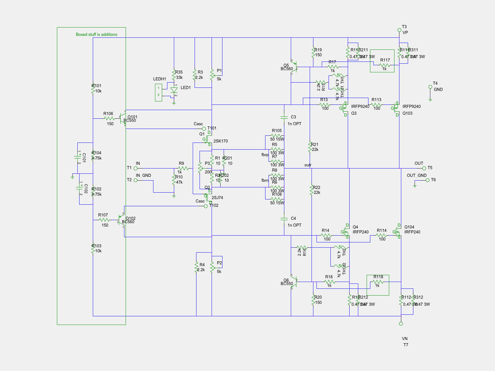

Something must be feeding those gates - gate stoppers form a RC loop with the gate, so at DC you shouldn't experience any difference when changing gate stoppers. As far as I recall, the distance from gate stopper to gate is quite short and the longer trace is on the other side.
Little update:
taking out the current current limiting resistors and bjt actually did something, will take out the fets and match at higher currents to make sure they are allright.
On a sidenote: The transforrmer stopped humming, i am prettty sure there was (or still is) oscillation. Now diner and then back to the bench.

as far as i recall with larger 177 Ohm gatestoppers the situation was seriously worse. I removed the current limiting circuit and will now reassemble everything for more testing, maybe we reached the point where i can put some square waves through later this evening.
...i am prettty sure there was (or still is) oscillation...

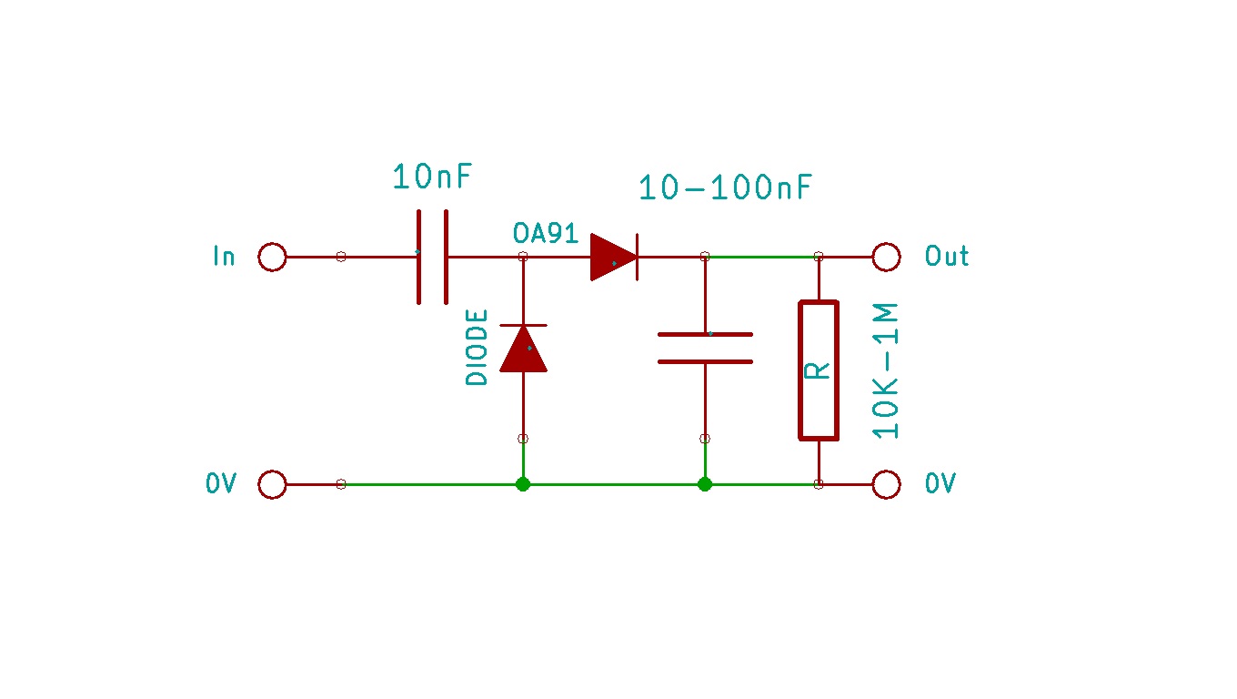

If you have, this should find it.
Its more sensitive than the LED one, but you do need to use germanium detector/demodulation diodes.
CAUTION
The OA91's are rated to 10V, an input spike more than that will kill the diodes, clamp it with a some zenners.

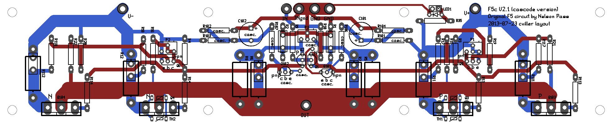

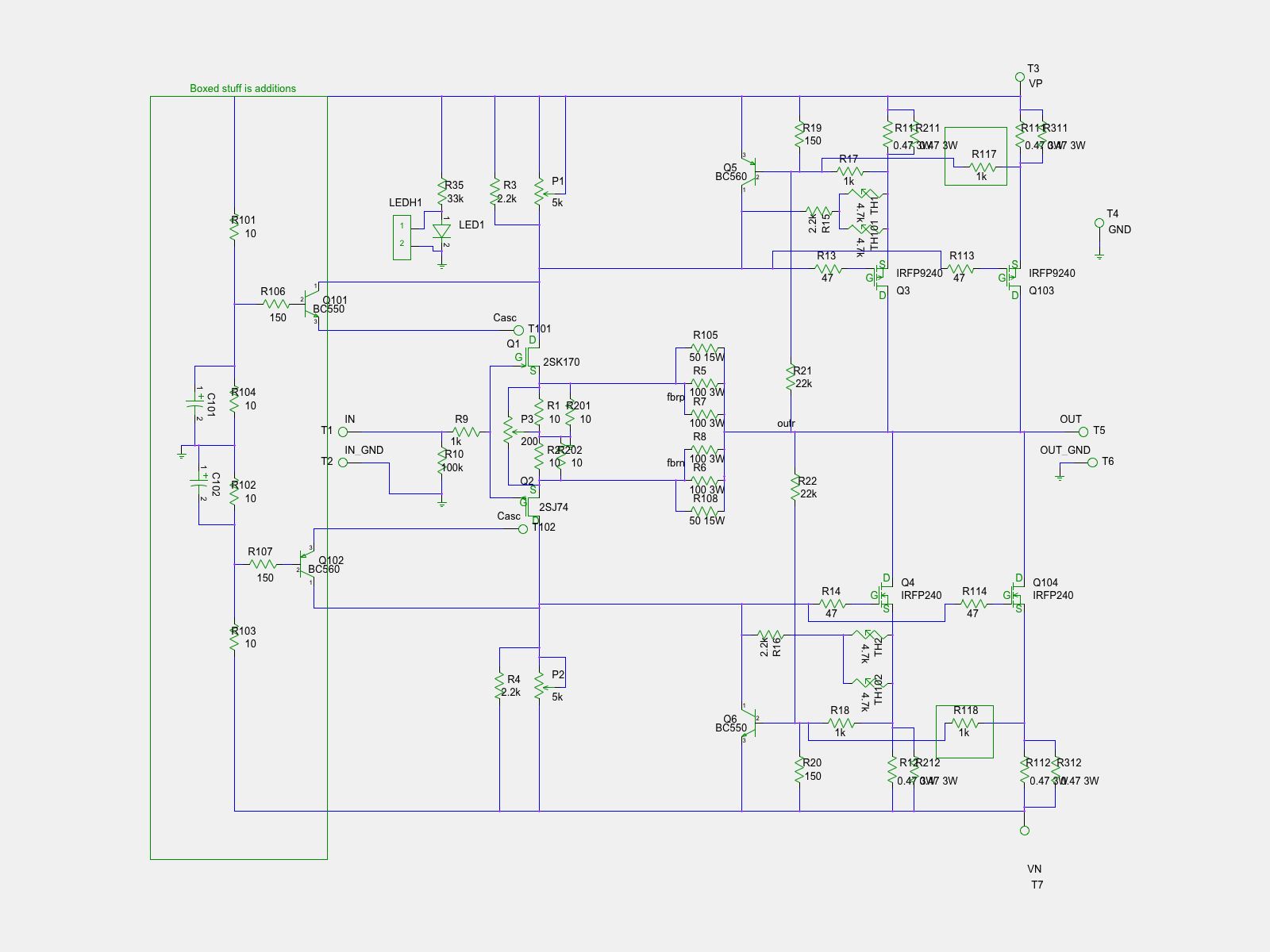

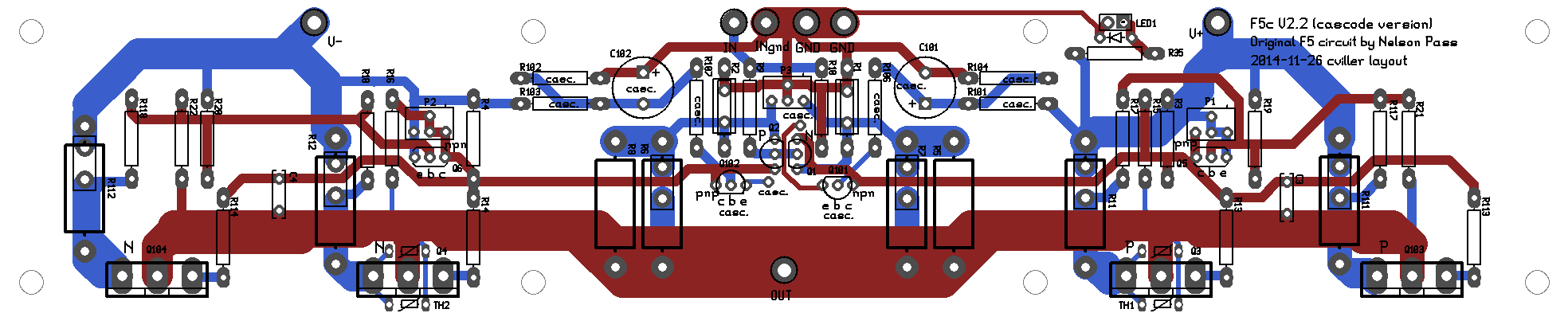

And I'll add improved vision by posting the schematics and board layout - sorry for not doing it much sooner. 😱
Ah great, many thanks cviller! That was definitely needed. I took everything apart, all semiconductors seem ok. I will put it back together and take measurements. I hope i still got my microsof paint skills.
Yes S74 was soldered in wrong, got it fixed, still roughly 315mV offset at the output. Measuring around 4mV across the source resistor of Q104 it seems that this little bastard is conducting a tiny amount of current. Q4 on the other hand does not.
4mv thats right around 8.5mA ... thats the IDSS of the Jfets.. hmmm could it be that the Mosfet Q104 is blown?

The state of the amp is back back to were we started. Matched fets from a forum member, 47 ohm gatestoppers, basically the only difference is that the current limiting circuitry has been removed
Its cooking now at 1000mA per device, target is 1250 mA. I want 100W Class A into 6 Ohm. Voltages across the current sense resistors are:
N-Channel: 491mV and 535mV
P-Channel: 509mv and 509mV
the P-Channel is still way better matched but the huge difference we had at the beginning is gone now. I will contact the seller of the mosfets and le him investigate. Do you think the difference is acceptable I think about ordering a batch of P and N Channel devices from digikey and match some myself. I will check this channel with he signal gen tomorrow and see how the square wave response looks, i will remove the current limiting circuit of the other working channel tomorrow too and have a closer inspection on its voltages across the source resistors, but as far as i recall they were ultra close.
Whats important to note: its now Q4 that has the higher voltage across the source resistor. before it was always Q104 no matter which of the mosfets were in the position.
And we might have one dead Mosfet (stll have to check), the replacement one from my parts bin, that was installed to check for matching issues. It was installed in position Q104. Up to now no evidence of oscillation has been found but measuring capabilities are limited.
