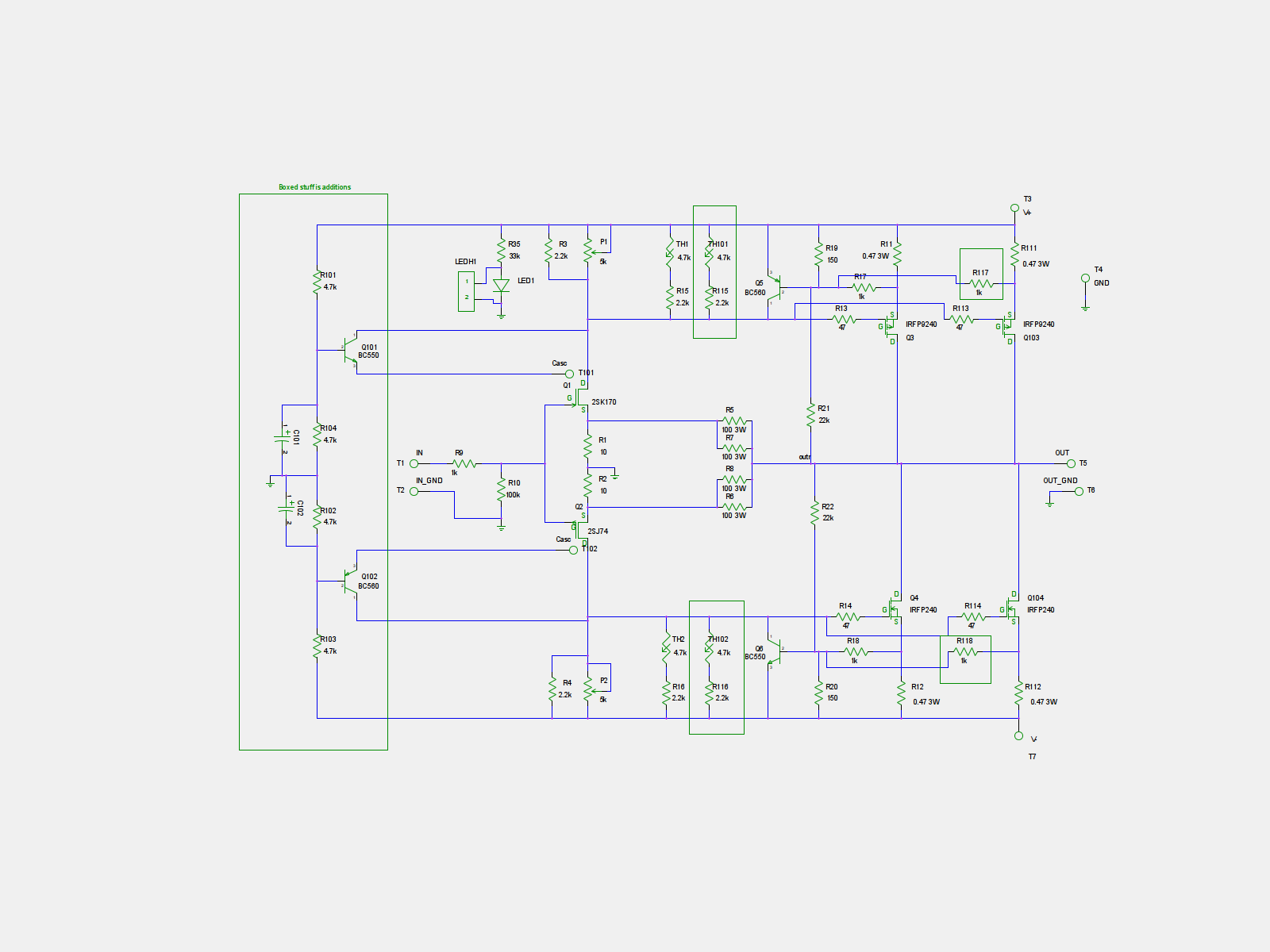

the P-Channel is still way better matched but the huge difference we had at the beginning is gone now. I will contact the seller of the mosfets and le him investigate.

Yes, i think there were other issues too, especially since removing the current limiting circuit did change things. I also changed the BC560C in the cascode when i rremoved them to check for errors. The new one might have smaller GM and that culd have solved the issue, we dont know. The other is channel working fine (have to check again tomorrow) with currrent limiting still in place, so the BC560C is still a suspect to possibly have caused the trouble. However there is still some difference in Vgs. Maybe we are already down to acceptable levels, i wouldnt mind some feedback on this.
Nic, no worries you will get your hands on the fets as soon as i have some replacements and have confrmed we have a matching error. There is other possibilities that need to be investigated first: Two N-Channel fets got mixed up between channels, that could have happened too. You have a curve tracer, right, otherwise the other fets would not match up that precisely.
I measured them out of circuit using a constant current source at various currents ranging from 5ma to 700ma. I wont rely on my low current measurements, in the "high" current measurements up at 700ma the Vgs difference is 0.125V. i think the other fets are matched way better.
There is also the possibility that the source resistors dont match. But i tested these with terminal measurement and the mismatch between the voltages is slightly non linear.

I think the choice of BC560C for the cascode should be discussed. Papa has chosen a tansistor 2SA11837 with vastly lower hFe. 2SA11837 has 320 max, BC560C has 900 max and looking at the frequency curves, the BC560 looks like a prime choice to build a radio frequency oscillator especially in the low current area.

You want to run 1.25A pr device for a total of 2.5A bias at 35V rails? That's about 44W heat dissipation pr device. That is alot.

How close are you matching source resistors R12 to R112 and R11 to R111? I expect they should be as well or better matched as the mosfets?

yes the source resistors were tightly matched using a constant current source. BUT, yes there is a BUT, matching was done at 100ma current. This means there is room for error, TC related error in particular.
