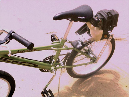

Don't underestimate the abilities of small belts.
The drive belt on the green bike (above) is only .325 wide, and it hauls me around well.
Depending on what I'm hauling around, my GVW is nearly 300#. I'm not a small guy...
You have other specs to worry about.
E
check into X series belts.
You are going to need them for your gantry.
The belt on these lathes is around 1/8", much smaller than .325. The other specs (im assuming your mainly on about rigidity) is not a problem. With a plain cylindrical workpiece my lathe has never chattered before the belt starts slipping. Therefore it is the main limiting factor, and other specs are adequet up to this level.
Steve
The belt (.200 wide) has never slipped on my Sherline.
The bike has a toothed X series belt, hence the suggestion. It doesn't slip either.
There is something wrong here... Might be your machines design? What kind of belt is it using (look for codes printed on it)? Sounds awfully spindly...

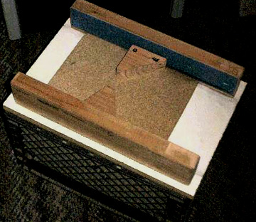

I was building a lid for my GC box, and came up with this...
It's a very precise sanding machine that works on any material, uses quality auto body abrasives, and is made from scrap lumber.
Anyone can afford to own this rig. And I've seen it work. It's far more accurate than a belt sander. Just takes longer.
Flip it over, and it presents a blank table just itchin' for another weird tool.
I'm gonna look into what else a guy could put in/on this setup. I'll bet you a beer that I can design a small, nearly human powered (+cordless drill + soldering iron...) GC shop...
That is self contained, and has lotsa room...
And build small, precise, and stylish GCs with it.
They'll make great presents...😀
