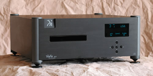

StuartAmbient said:Are there ways, tools, machines for the home shop I can use to make an extrusion. One example would be some front panels that have a wave or grooves in them. The other extrusion that I find very nice are the corner "standoffs" on the Wadia 861
I doubt they're extrusions, for $20000 odd that player costs Id expect them to machined (on a lathe) from solid bar.
For front panels, I guess you'd want maybe 1/4" solid ally sheet, and mill any shapes into that you wanted. I think I've got the right end of the stick there.
Steve

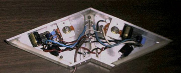

Very clean, Chipco. Very.
That is the first sink I've seen that addresses the "ringing" issue well. Does it sound as "dead", when you strum it, as it looks?

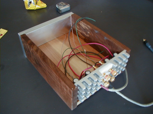

Listened to mine last night, looks like it is worth finishing. Oughta give you all a chuckle...

Is the shape of my second amp starting to make sense?
Like strumming barstock... They're 3/8" square protrusions, 5/8" long. Real dead.
The photo doesn't do justice to the walnut.
