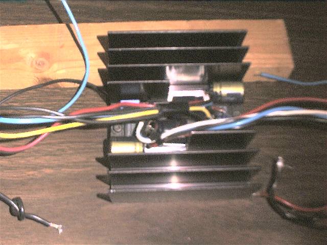

The heat sinking material for my 6ch is backordered...Rats!
So I started this (it was that, or pacing around).
