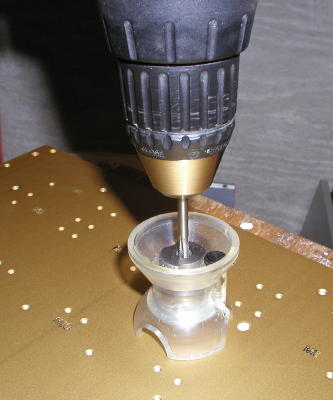

Magura said:The reason for the tap to break is if you move the drill accidentally, then its sure gonna snap. You obviously have very fine skills with a cordless powerdrill, but the average diy'er would brake a M3 tap if done like that, heck most people can hardly do it without the 1 kilogram powerdrill hanging at the end without braking the taps frequently.
On my Bosch cordless gun, there are 30 clutch settings. If you set it on the lowest range, you couldn't even break a smallest tap in your collection. It actually works as very good protection for people do it first time. The hand can be trusted that much.

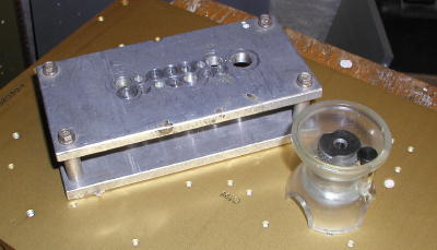

Magura said:Personally I use a CNC machine for my threads, but I guess the average diy'er also dont have such a tool as you showed on the pic....smart tool though.

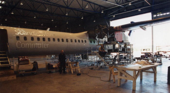

But the second tool can be easily made for different sizes, when access to drill press is available. The other one is available from aircraft tools suppliers. We used to use them all day, drilling skins in Stokholm
Here's rare picture of me, actually being employed
