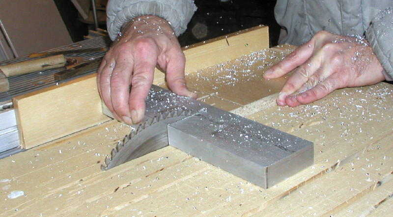

Since we already know that there is only one (as in 1) way to cut thread manually, here's one (of the ) ways to cut metal.

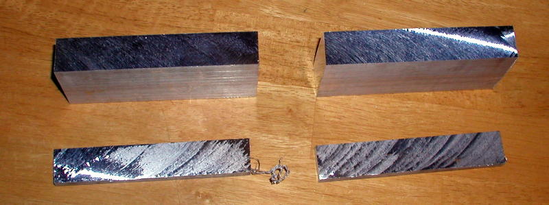

I needed two 1.00 x 2.46 x 5.50 aluminum blocks for today, and only material available at hand was a 3 x 12 bar. So I decided to mill it home style.😉
Here's the final look of the blocks, and they are well within the specs. I used Freud Non Ferrous Metals blade (78 teeth, or so).
Small pieces show the surface after first run. The big pieces look better, as I run them few times, to smooth out the surface.

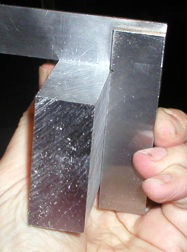

And here how square they are. It took me 20 min to do. I'd say not bad, and once again I managed to accomplish a task that for some seems like unavoidable way to contact proffesionals.

I thought I would offer some advice on sawing aluminum and blade selection.
1. Ideally, you want three (3) teeth in the material. The sawing process is controlled by the gullet area. In a finer tooth blade, the gullet area is reduced geometrically relative to the tooth pitch. As a practical matter, saw blades could have a single tooth and perform nicely if the feed rate was well controlled. (An example of this would be the fly cutter.) Since most shops, home or otherwise, don't have an infinite selection of blades, one may orient the blade or material to reduce the number of teeth in the workpiece. In the case of a table saw, this can be accomplished by raising the blade. This will reduce the distance any one tooth has to travel through the material. In that manner, the "length" of the chip (that has to remain curled up in the gullet) is reduced.
2. Some form of lubricant will greatly reduce the friction experienced by the tooth. Lubricants work at molecular levels so buckets aren't needed. Just a shot before you start, or apply several drops/sprays during the cut. Some suggestions might include WD-40, Boeshield, or wax sticks.
3. Good sawing in aluminum requires POWER. If there isn't sufficient power, then the blade slows down and the inertia is reduced and the blade slows down more, etc. On a table saw, the HP is pretty much set. However, the power requirement can be reduced by using "metal cutting blades". These will typically have more narrow kerfs (requiring less power) and "triple chip" grinds (high tooth and low tooth where the high tooth has both edges chamfered and the low tooth is still square, effectively producing three chips between a pair of teeth). Lastly, many non-ferrous blades will have expansion slots in the rims to reduce noise and prevent the blade from "potato chipping" (cupping).

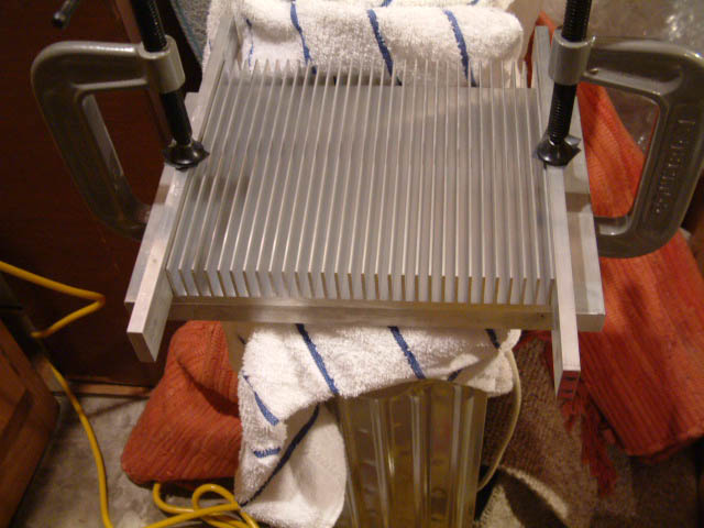

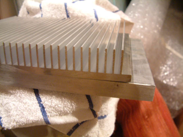

I tried clamping them down for 24 hours, to little effect. The other thing I was thinking about trying was to anneal them before clamping. I read somewhere that 6061 is pretty forgiving of the homebrew technique of heating to 500F in your oven, then quenching with water.

It is obvious from all the body of Peter's work, that he has a real "feel" for his tools, and materials. That is only developed by progressing in steps, and paying attention to variables as they appear (not waiting til something gets pulled out of your hand).
I have no fear for his hands. Period. My trepidation is based on fears given (sometimes in less than subtle fashion) to me by people that cared.
There is also nothing I could see in any pics that would suggest any possible outcome, but the one he desires. Look at his hands...
He is not commiting any of his balance to the cut. He can be out of there in a nano-second. Even if something gave way (the floor?), he'd leave intact. Can you do that?
I can't pretend to say I could... every time...100%...

What PD is doing here is not safe. There must be a guard over the blade to catch the workpiece if the blade decides to throw it after him....any workshop with a saw without the guard would be in serious trouble in europe....dont know about the american work safety law, but here we are talking fines in the level of 10,000 USD.
You should sit back and take 5 if you are not 100% sure you are 100% safe no matter what happens.....else you have quite a risk to end up needing 2 hands when ordering 5 beers 😉

bzo said:I tried clamping them down for 24 hours, to little effect. The other thing I was thinking about trying was to anneal them before clamping. I read somewhere that 6061 is pretty forgiving of the homebrew technique of heating to 500F in your oven, then quenching with water.

ekd said:He is not commiting any of his balance to the cut. He can be out of there in a nano-second. Even if something gave way (the floor?), he'd leave intact. Can you do that?
