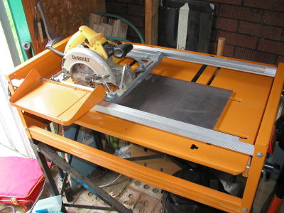

I used the setup below initially for any metal cuts. The material was firmly clamped to the table and I could slide the circular saw over it. It was very save, but not convenien, required too much time to setup and accuracy wasn't what I needed. Later, I tried using a table saw, and results are very good.
Safety glasses are mandatory and I'd rather recommend proper judgement than blindly following safety rules. Sometimes the rules act against your personal safety and only you can decide what's you comfort zone is.

What Peter shown here seem very safe compare to my first usage of a mitre saw for diy audio. It came with a standard 10inch ripping blade and I used it to cut a roughly 4 inches by 3 inches PCB, trying to trim an inch off. Used just my left hand to hold the PCB and my right hand pull down the saw and POW I could not see the PCB anywhere except just some red pieces everywhere. No, not my blood, the red bits were the red platic blade guard at the base of mitre saw where the blade goes thru. The blade flexed/wobbled so much and yet I was lucky my left hand did not moved or jogg with reflex action otherwise ...no there is not enough do and don't do regarding partical usage of power tools...

Might be best to point out that its a horizontal tilting bandsaw for metal (dunno if it has a technical name), not the vertical woodwork type.
