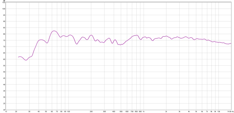

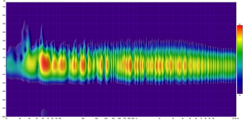

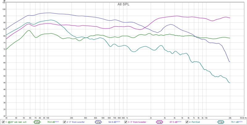

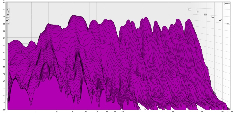

I was able to get my hands on a UMM-6 and have been playing around with REW for a little bit now and have been able to produce some graphs that should hopefully be useful for analysis. Based on some initial testing I discovered that stuffing the vent with Acoustastuff and Acoustic foam has helped to decrease floor bounce dip after 150 Hz. I made a quick and dirty 10" stand, which was recommended to aid in the floor bounce as well; the right channel testing is largely showing the difference with and without the stand.
Attachment 1: Stereo Frequency response, Mic at at listening position

Attachment 3: Stereo Waterfall, Mic At Listening Position
Attachment 4:Right Channel Only, 10" Stand

I am sure that my tests can be improved upon, but hopefully they should be sufficient for preliminary analysis of performance. All graphs have 1/6 octave smoothing on.

Those measurements look pretty good. Is this the original TL version or the revised BR version based on the port size recommendation I gave? How far away is the back wall? What is distance from speaker to mic for the listening position case, and is that with two speakers?
Hi XRK971,
This is the original TL enclosure, but I have experimented with filling the port with a combination of acousta-stuff and acoustic foam; This is as good as I have gotten it thus far. The first three attachments in my previous post are with both left/right speakers.

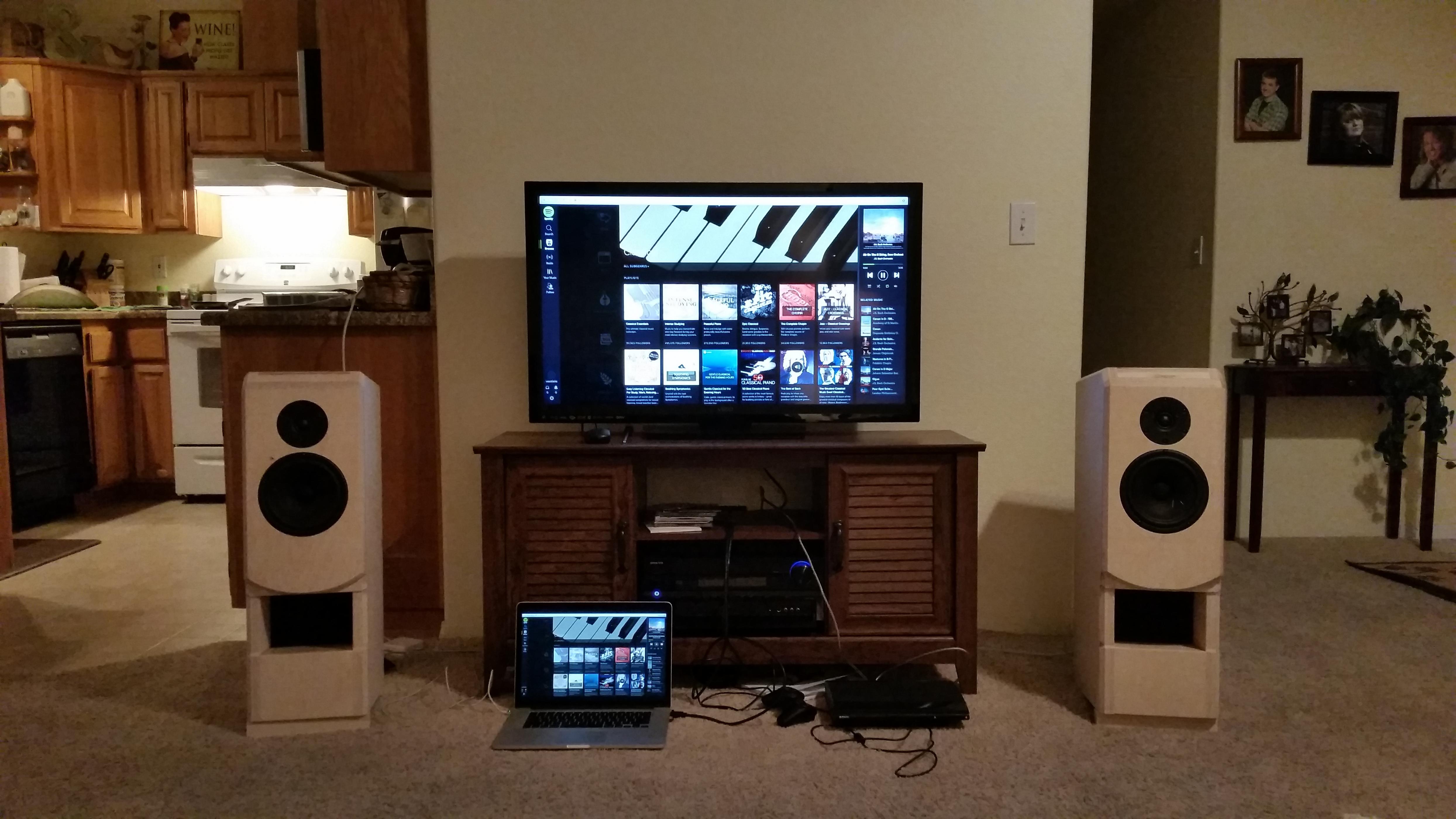

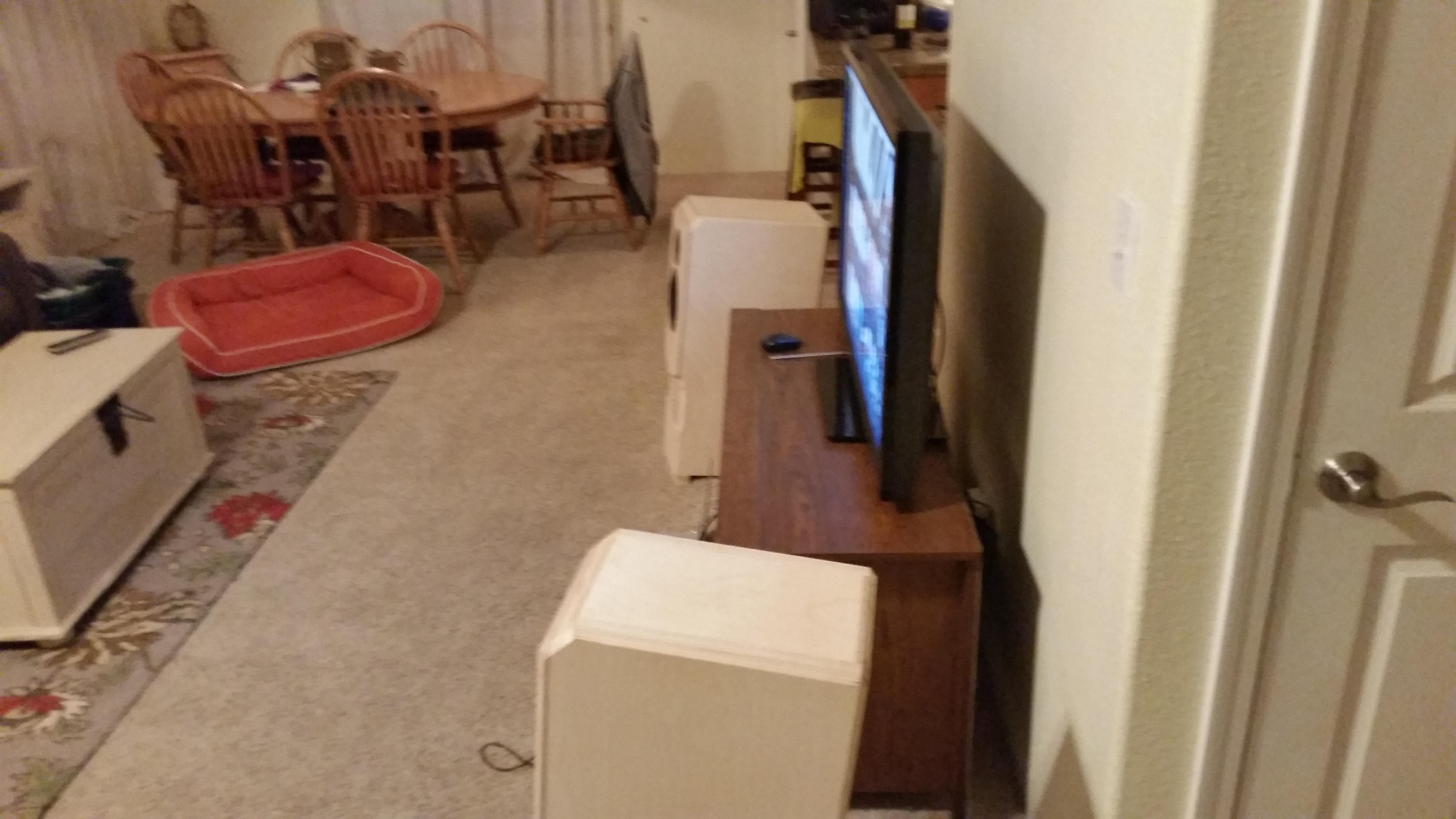

The position on the mic is approximately 6.5-7 feet from either speaker, and the speakers are approximately 1 ft from the back wall, but as you can see from the attached picture, the space behind the speakers is an interesting shape. The last three attachments in my previous post are just the right speaker; the tests show the results of using as is and with a 10" stand.

It looks like your stuffing seems to have done the trick and the output is much smoother than the sims would have suggested. Did you make any measurements before you added the stuffing?
I did, but didn't save any of the data or the REW file, they for the most part were pretty similar to the predicted responses that you posted, though I would say a little bit better in terms of the dip in the frequency response.
