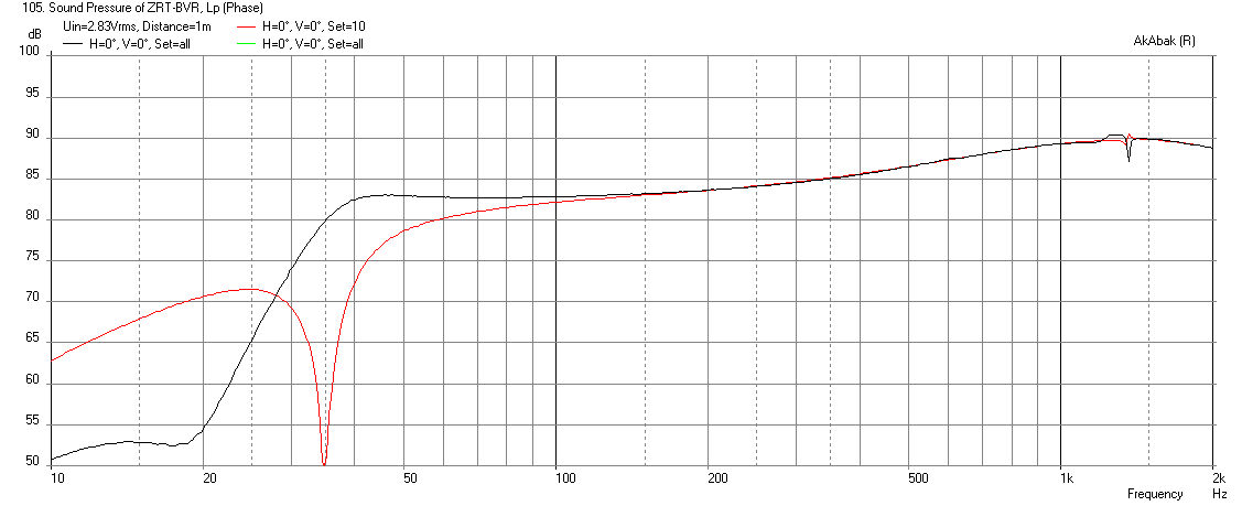

I don't know the internal depth of your box, but assuming that if you sealed up the front vent mouth and perforated the divider wall, you can get 39 liters. Assuming a 39L volume, put a 3in dia x 10in long rear facing bass reflex vent towards the bottom and you can get the response to flatten out like this. Here is 4pi space - no reflections but baffle step losses accounted for. Assuming your baffle width is about the same as the original Zaph design, the XO should handle the -6dB loss due to baffle step for you. This takes care of all the lumps and dips from 150Hz to 700Hz. Sometimes, simpler is better. If your volume is different than 39L, use an adjustable length vent and tune to taste.

Here is the response of just the woofer with no XO applied:

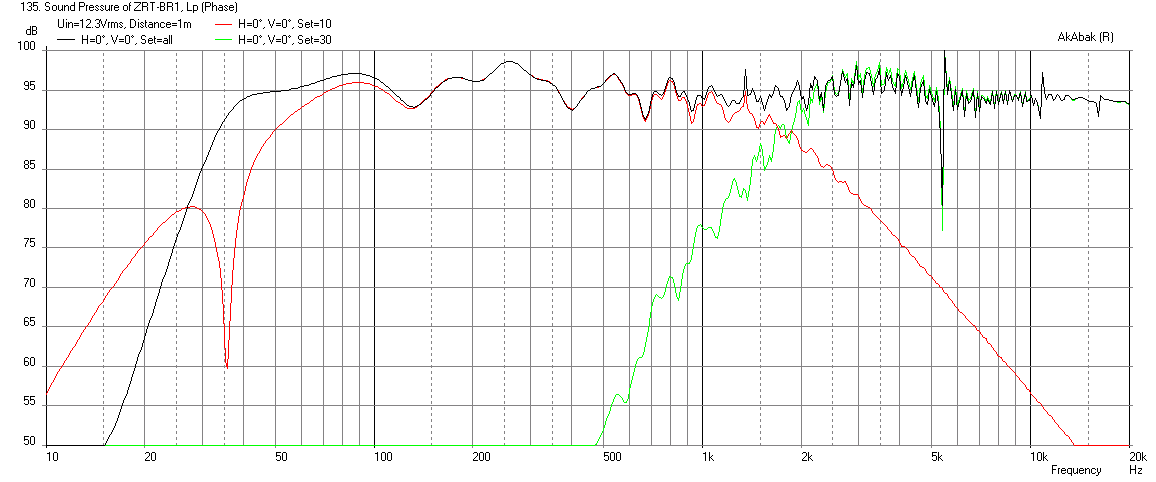

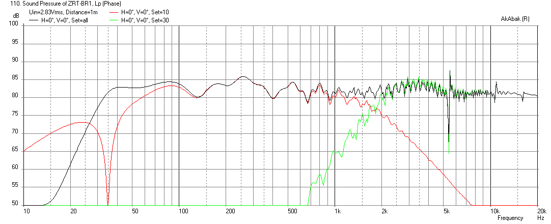

I entered the Zaph XO parts into the Akabak script and placed speaker on a stand so that the woofer is at 40in above the ground and the speaker is 5 ft away from a back wall for this sim. It appears that the Zaph XO indeed accounts for the proper baffle step loss. This speaker actually looks very good now with the BR vent positioned to be backwards firing and located -12in below centerline of woofer.
Here is predicted response with reflections and diffraction turned on:
Compare this to what you currently have if you left it as is:

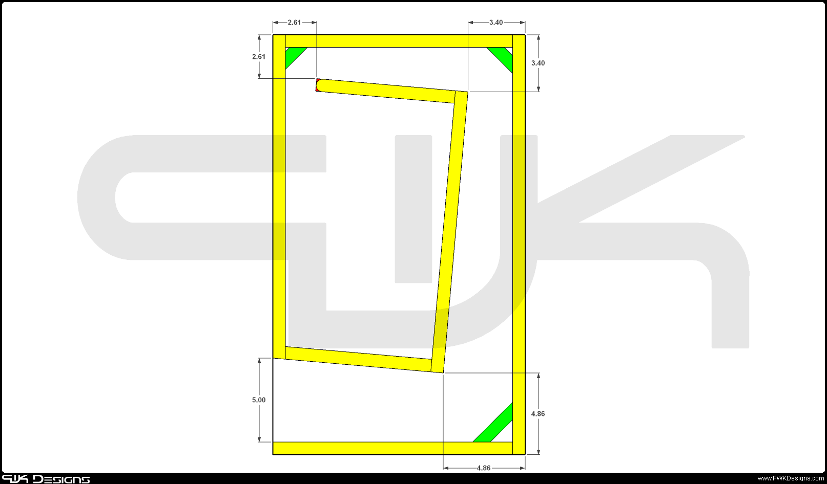

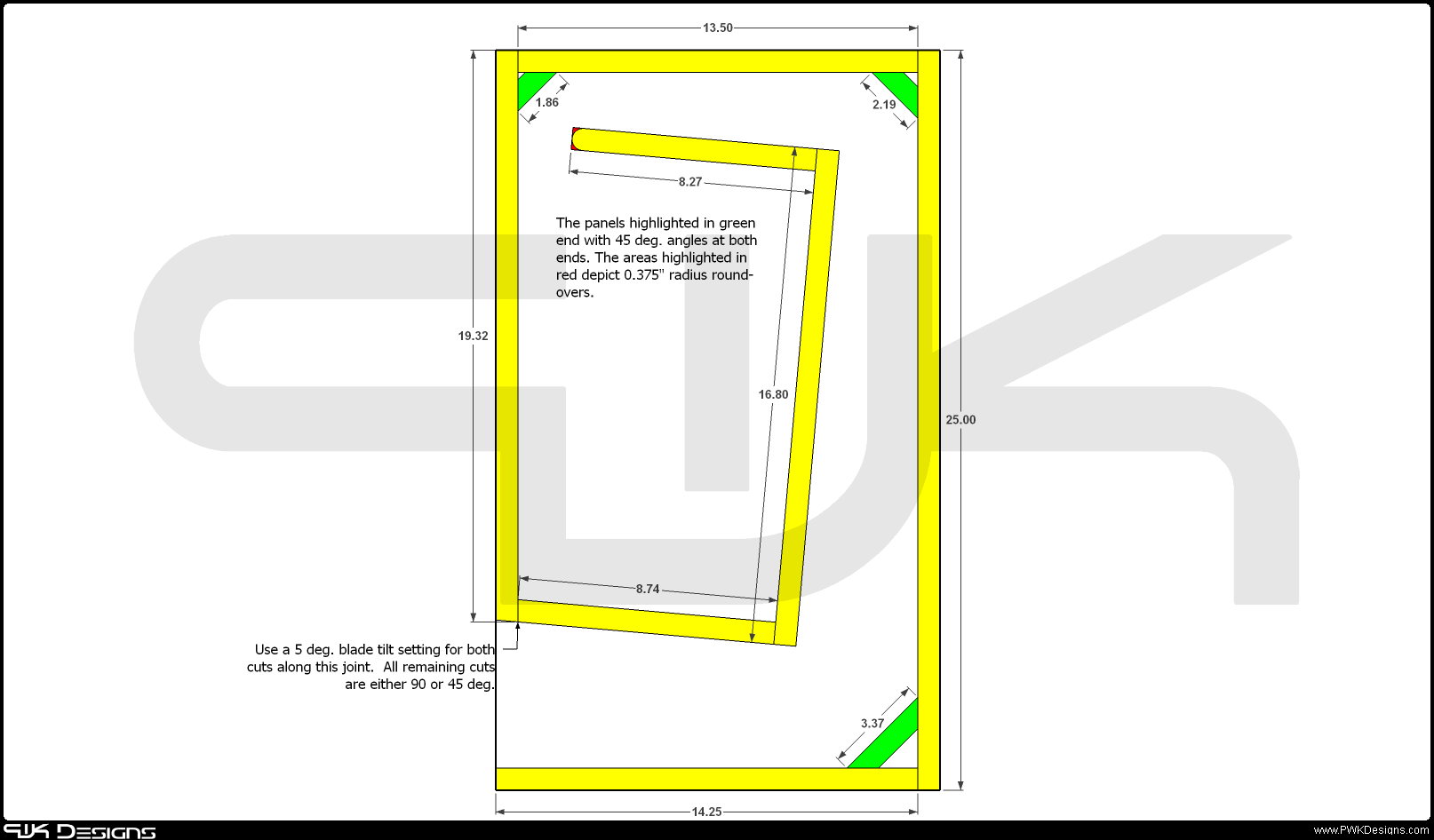

I have attached some drawings that show the internal geometry to give a better idea of what is going on and possibly show locations for a bass reflex vent. The difference being that the front baffle of my enclosure is 1.375" thick (still maintaining internal geometry), and that I placed a 1.65" bevel on the front top (at the time in my mind I was lowering the effective height of the baffle). this means that the tweeter is sitting at 4.65 (3 inches from bevel edge) inches from the top and the Woofer is 10.65 inches from the top (9 inches from bevel edge).
All of the internal panels are 3/4" (closer to .7" though). Due to access problems it may be difficult to adequately perforate the back panel of the compression chamber, but i am definitely interested in making these better, so I will take a look to see what can be done

My 39 liter guess is just about spot on based on the dimensions you provided. Maybe 38 L with volume of internal panel and corners subtracted but that won't change things much from vent tuning standpoint. Get a 2in Forstner bit with long extension like the kind used for installing in wall wires. Drill as many holes as you can using driver cutout as access and vent mouth as access. Then add stuffing inside but careful not to block vent. Mount vent 2.5 in from bottom on back side. It may work from front side too if you prefer front firing. Use 3in sch 40 PVC if you can't find real vent long enough.

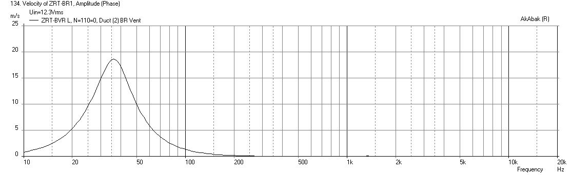

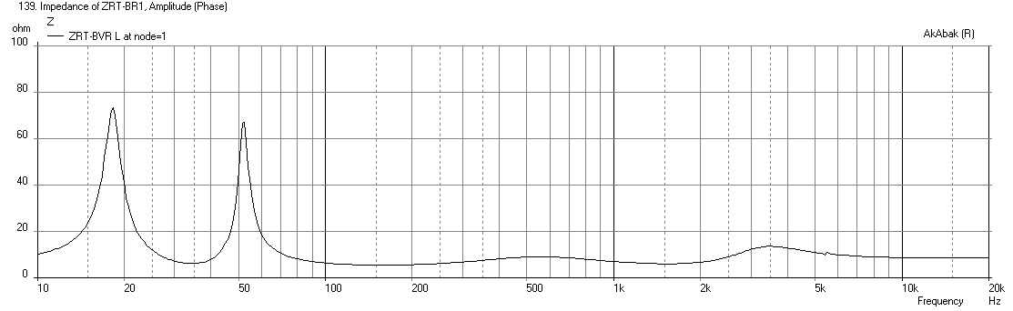

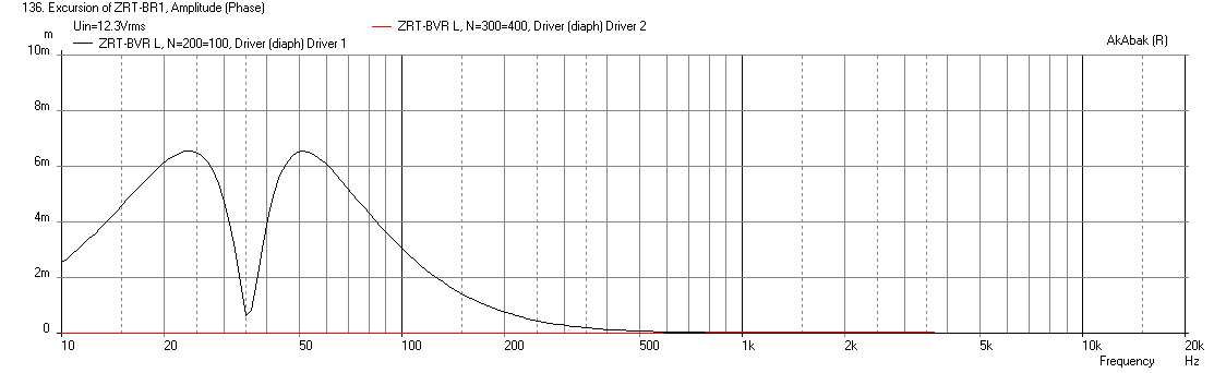

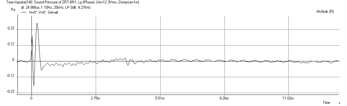

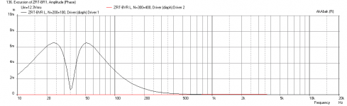

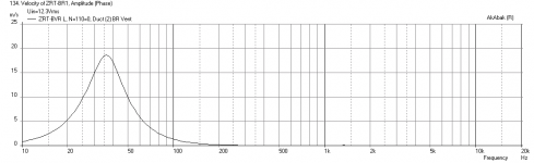

For a 2.5 in ID vent use 6.5 in long vent. With a -12dB/oct HPF at 34Hz to prevent cone over excursion for low freq content, you can drive the woofer to 12.3volts. The peak velocity in a 2.5in dia vent will be 18.6 m/s at 35 Hz - which is a little high actually, so you may even want a 3in duct if you want to avoid chuffing. Another reason for a rear facing port (hear less of it).
Predicted response with HPF in place:
Cone displacement with HPF at xmax:
Impedance:
Velocity at port:
Impulse Response:
