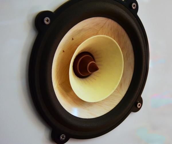

I glue the cone to the surround with the cone placed top down. I post up the photo bit later, so you will understand it better.

Close up on the surrounds as requested
[/URL]An externally hosted image should be here but it was not working when we last tested it.
[/URL]Very interesting, and great work!

Ghemml,
Many Thanks ! Are the Surrounds Foam or Rubber ?
Jayant
Rubber surround on a full range driver is not a great idea. Foam is better, but cloth is superior.

I also find rubber not suitable for fullrange, they are too heavy and thick.
The foam I used was originally used on Hivi, I selected it after searching through a vendor's inventory which is thin and soft.
The only recone kit which I'm very interested in is the lowther surround kit I found on ebay.
