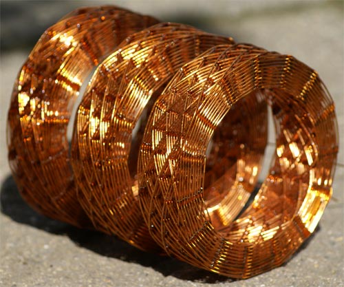

Still haven't got the time to test out Honeycomb inductors on loudspeaker crossover even though I have the winding machine for it which end up winding for my fullrange VC.
