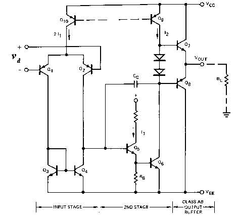

Claude Abraham said:
.........It will become apparent that in a CFA, the error signal that the output drives to zero is indeed a CURRENT, the difference between the first stage emitter currents, which is the current entering or exiting the inverting input terminal, or "neg" terminal.
If this were true, then it might quite reasonably be applied to the generic voltage feedback topology shown below.
For it could then be urgued that the error signal driving the foward path is a current, being effectively the difference between Q2 and Q4's collector current.
This may at first appear true as this 'error' current is directly proportional to the voltage vd, further downstream.
But is vastly incorrect because this current merely represents an effect, with the causal error signal being the differential voltage vd.
Therefore, for both topologies it is clear that the error signal resolutely remains a voltage. viz. The difference between input and feedback voltages.
That this error voltage is subsequently expressed as a current downstream is of secondary significance.

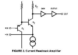

..........Anyway, let me revisit what CFB-terminology critic Dr. Cherry wrote in his paper, discussed here often.
On p337-338, he writes:
"Stripped of its input level shifters and complementary first stage, and with the current mirrors and voltage follower replaced by the simplest inverting amplifier (a single common-emitter transistor), the current-feedback amplifier reduces to Fig. 6. A generation ago this circuit was called a voltage-feedback pair. It differs from Fig. 2a only in that the current flowing into the left-hand side of the feedback network is the input current multiplied by the gain of the first transistor, as distinct from the input current itself."
Folks, the very parts he wishes to "strip", are exactly the parts which make the CFA uniquely different from the VFA. If the EF and current mirrors are replaced with a common-emitter (CE) amplifier, OF COURSE it reduces to a VFA. In a CFA the EF forces Vn to equal Vp, whereas in a VFA the output voltage and feedback network do this. In a CFA the current mirrors reflect the current difference in the feedback resistor pair over to the transimpedance stage, and charge up the comp cap, driving the output voltage in proportion to the difference CURRENT! Without the parts Dr. Cherry wishes to strip, the error signal becomes the voltage difference between Vn and Vp. A VFA is all that remains. You can't just remove critical parts at will, and then claim that this circuit is just like any other! If I were to clip all of the feathers off of both wings of a bird, does that "prove" that a bird doesn't really fly, and that it is just another land animal?
This is incorrect...Dr. Cherry was right in all respects. See figure below obtained from:
http://www.national.com/an/AN/AN-597.pdf
