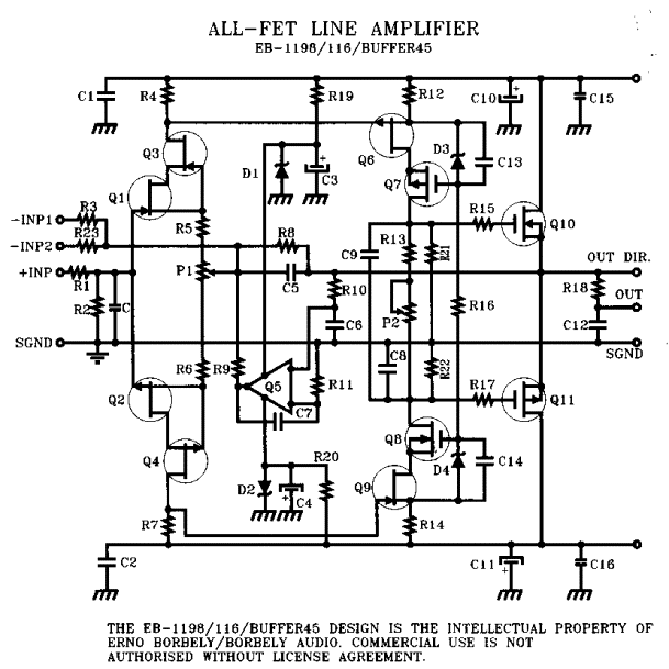

Thanh,
Some people might disagree with that.

Either we can call it an CFB amplifier when the feedback sense a current "information" over a shunt resistor OR when the feedback input node sees a "current signal" becausem of a transimpedance stage, OR why not both....?
The first case could be called "current shunt feedback"
and the second case could be called "current transimpedance feedback", eg. two type of CFB with distinguished difference in their naiming.
Just a proposal.
Cheers 😉
