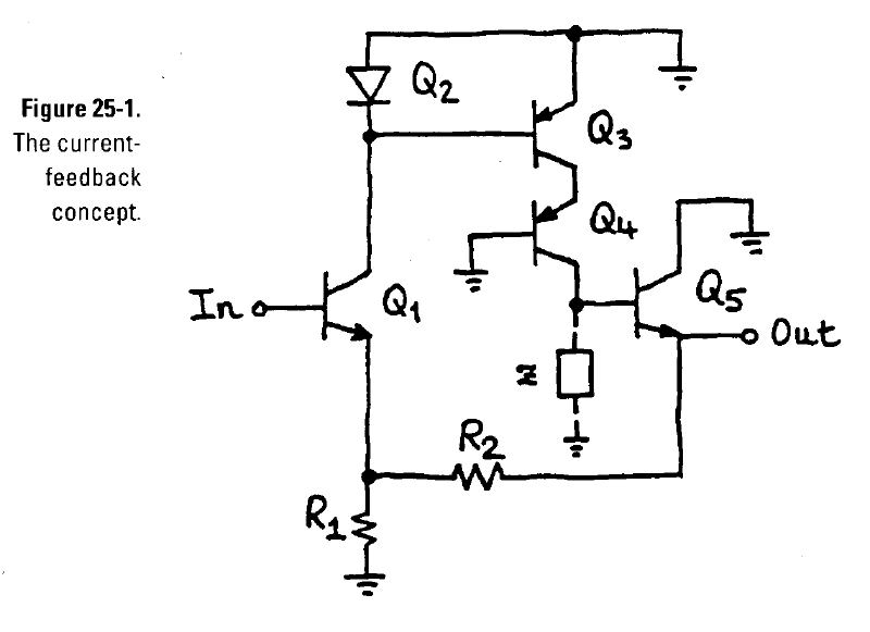

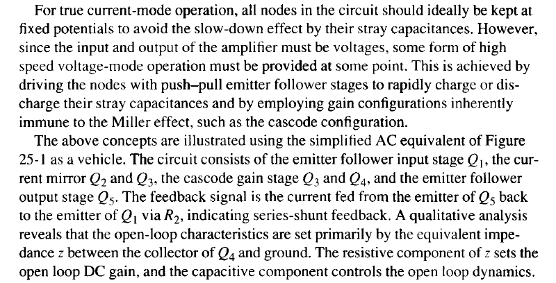

Here is an explanation on how current mode amps work. Written by Sergio Franco.
Notice the mention of series-shunt feedback.
So there!
So there!
yup....series-shunt.....in other words, voltage feedback.....
....the rest is rather dubious though...... :scratch2:
for thorough appreciation of this unfortunate topology, see Cherry....
Yes, isn't that curious. Cherry dissects so-called CFB opamps and comes to a rudimentary diagram which looks a lot like Fig 25-1, but his conclusion (reasoned) is also: voltage feedback. Maybe I have to read Cherry again. The mind starts to boggle...

of course it is voltage that's being fed back to the input: a current feedback amp produces a voltage signal.
so you couldn't have x-series feedback configurations on a cfb.
I thought that was clear from day one.
