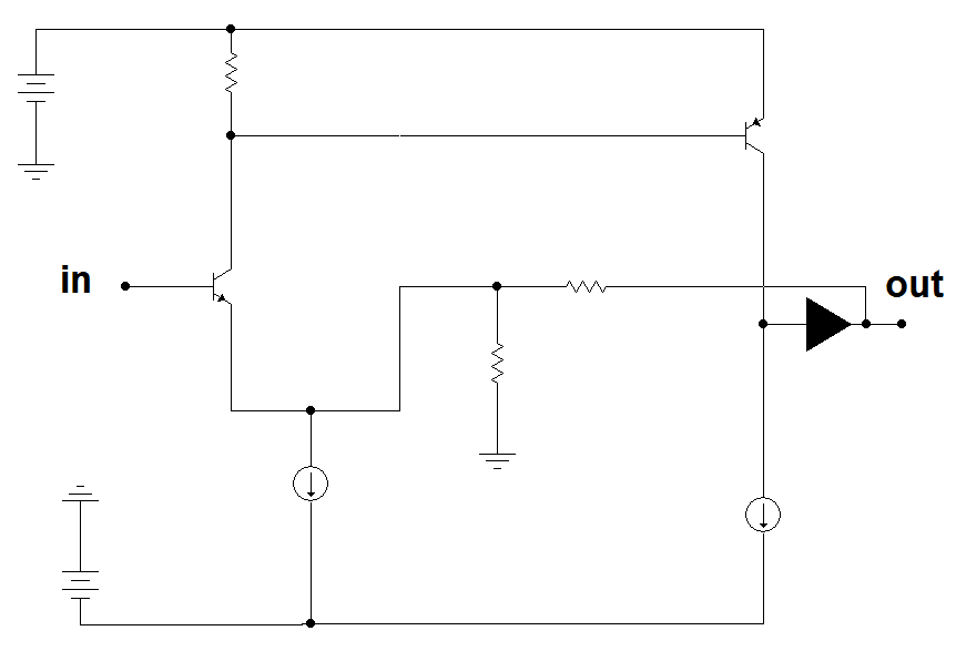

Mikeks,

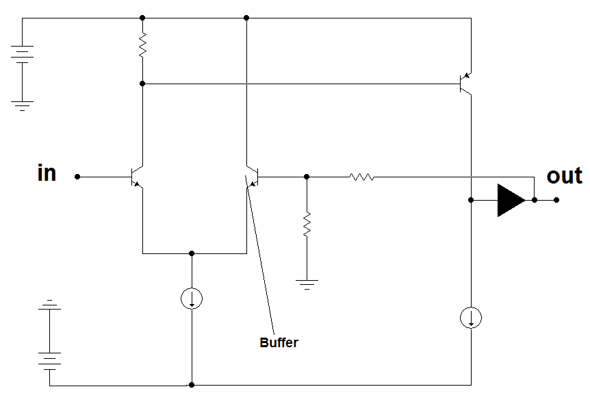

Regarding the two schematics you just posted. It is still the case that even if we assume the transistor is a theoretically perfect transistor behaving according to the first-order model, it will not have the properties of a theoretical perfect unity gain buffer, but have som output impedance, a gain slightly less than 1 etc., so it is not quite the same as the theoretical CFB op amp as used in most papers. Most would probably conisder it as a practical implementation of CFB, assuming component values that makes it approximate the theoretical model.
However, if considering it as a practical implementation, you make a good point by referring to the second transistor in the diff pair as a buffer. What you do here is basically the same thing National does when they turn the 6181 CFB op amp into the 6171 VFB op amp. That would mean that we suddenly view the usual diff pair as two buffers fighting each other, which seems perfectly all right. There are usually many ways to look at the same thing.

mikeks said:
So, first you tell me you think the emitter follower is a buffer. Then you add another emitter follower, which you also call a buffer, and you end up with a diff amp. One plus one is two, as long as we don't redefine the usual mathematical symbols. How am I to interpret your exercise other than that a diff pair actually is a combination of two buffers? I still haven't learnt to read you mind, Mike. Expressing yourself in longer sentences than one word will probably help.
