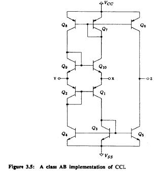

I will ask again: what defines bias in following circuit?
I see only positive feedback, i.e. the higher questient current, the higher questient current.

That circuit does not look like any of the typical CFB/CCII+/H-V amp inputs stages that I have seen, so I am somewhat puzzled by it too. I also agree it seems to have a potential problem with thermal runaway, but so does certain other input circuits that seem to work in practice, like the Rush cascode that has been discussed quite a lot recently. If you see that circuit in an IC data sheet, it is most likely a simplified schematic and there tight transistor matching might perhaps help too. Personally, I would like to see some additions to the circuit to ensure a stable thermal behaviour. Some degeneration resistors might serve that purpose, perhaps.

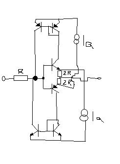

The circuit I mentioned before seems to derive from Hawksford's error correction circuit, but Hawksford's is way different, because uses fixed bias by means of external current sources and no positive bias feedback, only error correction.

Christer said:
[snip]If you see that circuit in an IC data sheet, it is most likely a simplified schematic and there tight transistor matching might perhaps help too. Personally, I would like to see some additions to the circuit to ensure a stable thermal behaviour. Some degeneration resistors might serve that purpose, perhaps.
It IS a simplified circuit. The actual circuit has lots of additional circuitry to set up the bias, and there is also emitter degeneration. But that's the silicon implementation, the thing can easily be used with only this circuit for the design.
You have to know though the bias currents in order to size the input/output currents for best linearity, of course.

'Current conveyors' are really a development of so-called operational transconductance amplifiers, and have some similarity with 'CF' and VF amps in the sense that applying voltage stimulus to the non-inverting input causes a virtually equal voltage to appear at the inverting input in a closed loop arrangement.
Crucially, however, while the current appearing at the non-inverting input of an ideal current conveyor forces a virtually equal current to appear at the inverting input of a 'current conveyor', this is clearly not the case with so-called 'current feedback', op. transconductance or, indeed, generic voltage feedback arrangements.
Therefore, calling a 'CF' amp. a 'buffered current conveyor' is rather misleading.
Once again you surprise me! I've used CFB op-amps ever since the AD811 first came out, and the internal structure of this device, and just about all other CFB op-amps is indeed a CC-II with an output buffer feeding from the internal high-impedance node of the CC-II.

janneman said:
Indeed, Mike, it appears your understanding of a CCII+ is slightly off.
Jan Didden
Guys, you are absolutely right; i was refering to CC1. Apologies!
However, i fail to see how a 'CF' amp could be described as CC2, as with the later, feedback is returned to the 'X' node from the high impedance node... :scratch2:
