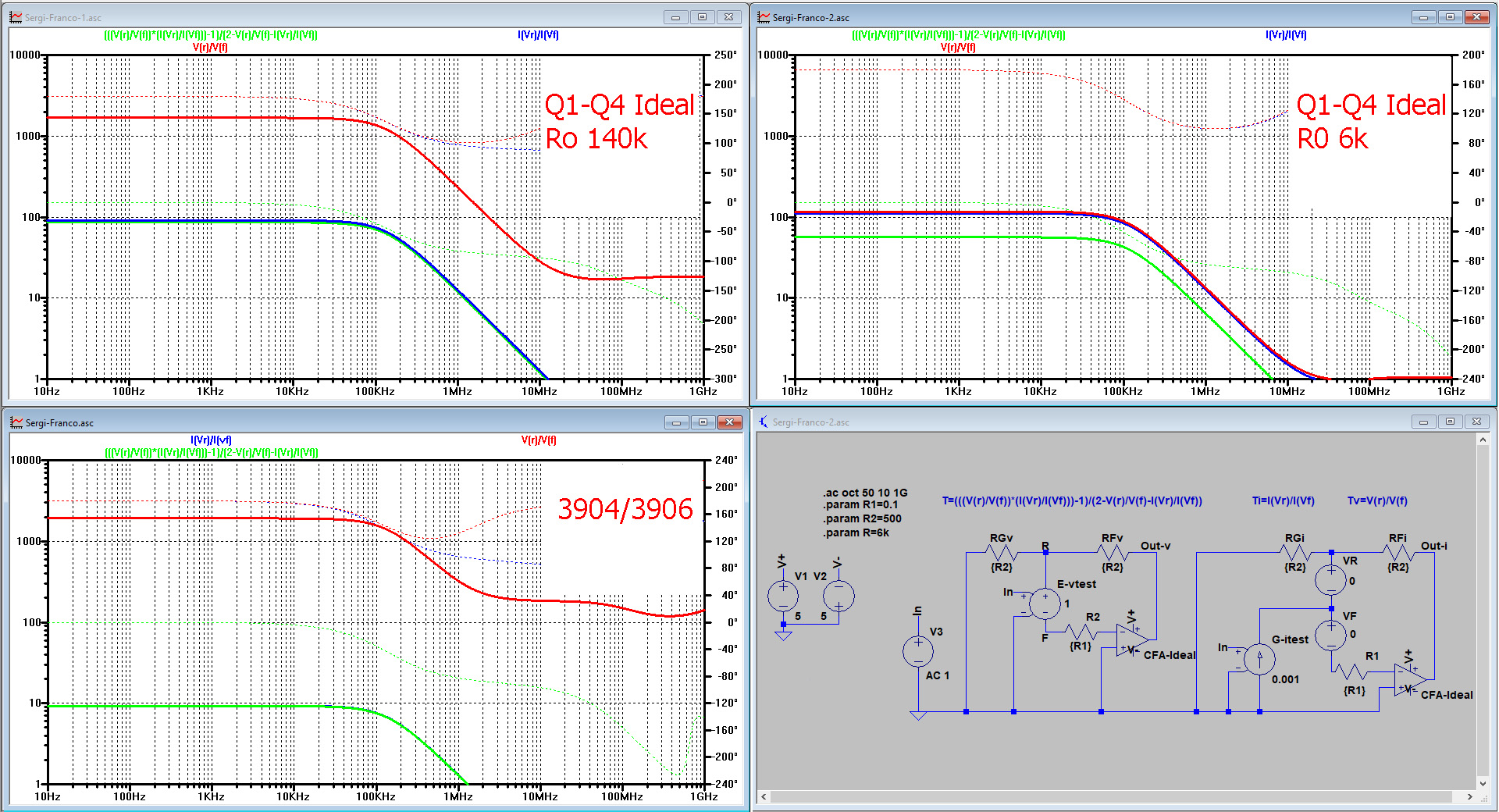

https://www.edn.com/design/analog/4458753/3/In-defense-of-the-current-feedback-amplifier
By doing that, three transimpedance T curves can be obtained.
Ti by means of current injection, Tv with voltage injection and the loop gain T.
When the FR plot of Ti is close to T's plot, it is a CFA.
When the FR plot of Tv is close to T it is a VFA.
When Ti and Tv are equal, we have 50% CFA and 50% VFA.
1/(1+T) = 1/(1+Tv) + 1/(1+Ti)
In this model everything can be investigated, like the effect of an impedance at the inverting input, early effect etc, etc.
As long as Ti is much closer to T, it definitely is a CFA.
If we can agree on that, the discussion has made a Quantum leap forward.

In post 1266, Hans cites Middlebrook's technique for determining whether there is more current or voltage feedback in a loop. In the first part of my article Current Feedback: Fake News or the Real Deal? | audioXpress, I point out that when you apply this at the inverting input of an op amp, this simplifies approximately to whether the impedance presented by the feedback network to the input is greater than that of the input or not. If it is, we have predominantly current feedback; if not, predominantly voltage feedback.
Note that it is possible, and in fact some CFA manufacturers suggest, that for certain gains, the network impedance actually be less than that of the inverting input. So they recommend in these cases to operate the IC with predominantly voltage feedback!
Obviously, we're not going to call this a VorCFA, but we'd like to name the topology.
So here's another observation: for all CFAs, the signal current flowing through the collector is not merely approximately equal to, but is in fact entirely supplied by, the current presented by the feedback network back to the transistor emitter. Hence, current feed back.
Hi Chris,
I did what I proposed yesterday and simulated the way Sergio Franco and Walt Jung did.
I used 3 versions: the first your original version with the 2N3904/3906.
Second, the input buffer Q1-Q4 equiped with ideal transistors, all others as before. this time with an Ro of 140K, being the resistor caused by the early effect.
And Third, as number two, but now with an Ro of 6K.
In the graphs below, the green line is the ideal transfer T, Blue is the transfer when injected with a current Ti and Red is when injected with a voltage Tv.
As long as Blue is very close to Green and an order of magnitude from Red, we have a CFA.
The other way round is a VFA. When Blue and Red are equal, we have 50% CFA and 50% VFA.
In your case with the 2N3904/3906 it is definitely a CFA.
It is still a CFA with and ideal inpur stage, shunted by 140K early effect resistors.
Only when Ro becomes 6K, VFA and CFA are equal and we no longer have a CFA.
So in your case, I see no reason why your 2N3904/3906 cannot be fully reckoned to the CFA category.

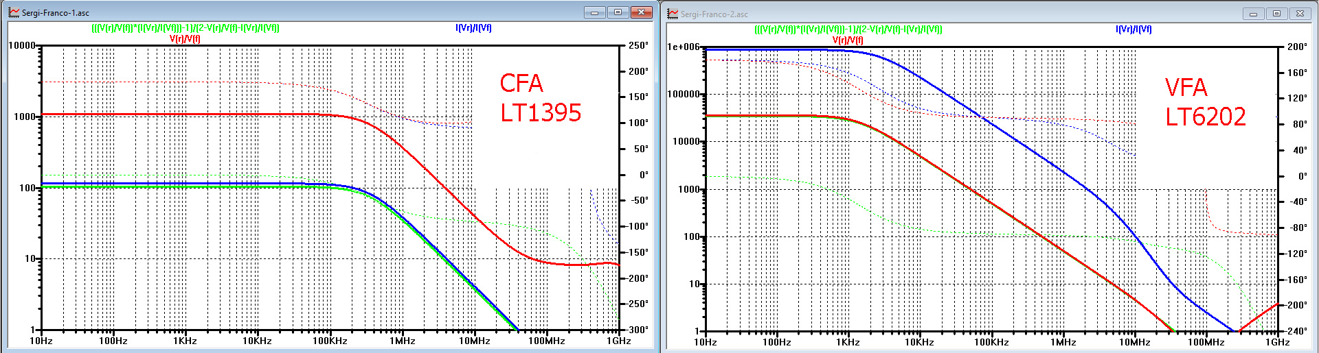

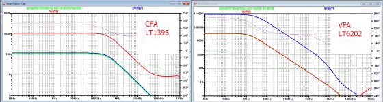

I will still come with an example of a LT1395, a pure CFA and a LT6202, a fast VFA.
Hans

Hans, you seem to be trying to convince me of something that I never contested. Why? Please see my post of a few minutes ago. "What we have here is a failure to communicate."
That is what I was afraid of all the time.
I had difficulties in understanding the significance of your point in #1228, and had the feeling that the Early Effect plays no role at all, which is now proven by my sims.
Hans
