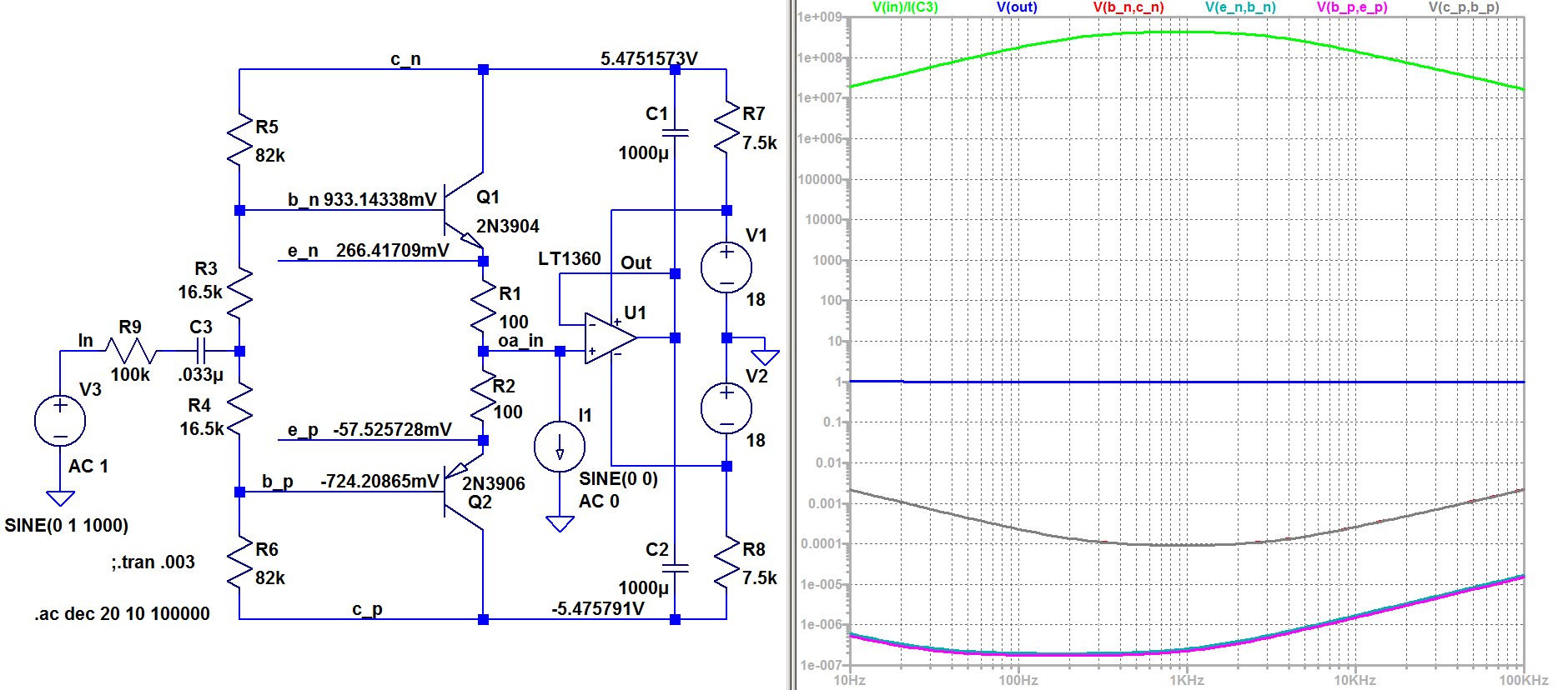

The circuit you recommended gave me an idea. Not having a lot of JFETs around, I am looking into a scheme with BJTs. The attached is looking very promising. I just grabbed a wide bandwidth (20MHz) op amp available to my simulator. Although Zin measures in excess of 10Mohms, the op amp input sees only about 1k, something critical to minimize non-linear capacitance distortion. It's just as critical to do this for the transistors. The base-collector ac voltages are 60dB below the input signal and the base-emitters are 110dB down. Response at the output is within .1dB. All values apply across the audio frequency range and are derived using a 100k source. I'm looking forward to testing this.
For AC conditions the two 82K Ohm resistors appear in parallel to an effective ground, hence the series 100K Ohm seems feeding an equivalent 41K Ohm to ground. This seems would attenuate the input signal to about 1/3 or 10dB.
Although attenuated, the lowering of the source resistances to the bases increases bandwidth given the combined base/collector capacitances of the NPN and PNP transistors being approx. 8pF (4pF for each device). Hence dropping the source impedances seems would also triple the bandwidth given the capacitances don't change.
Sorry... I see you've coupled the collectors back. Perfect.

I was surprised that the AD846 data sheet was still up even though it was obsoleted years ago. It has a DC transimpedance of 200M Ohms due to lots of cascoding, etc., that's 166dB Ohms so my second results apply to well below any audio frequencies. So the displacement current in the compensation capacitor (the current into the inverting input) is all that matters at audio frequencies.
The 100pF impedance in your asc file seems excessive. The datasheet says something like 4.5pF. If I sim the asc file without any added capacitor, I get frequency response very close to what the datasheet supplies.
That sim has nothing to do with the AD844 or AD846, nothing at all, the transistors and process are totally different. Putting 3904's and 3906's into a simplified AD844 schematic is not simulating the AD844. I'm expecting too much, I appologize, stuff like this can only be done person to person the chat forum process simply can't work.

I was hoping to ask you a simple question about a sim result in a CFA made without controlled sources. Scott Wurcer provided one only a few posts back. I provided one in post 1028. If you accept either as realistic, let me know. Or supply one that you prefer.
Right, but I put the '04's and '06's in an LT1395 sim and you put different transistors in the AD844 sim. But I certainly take your point about process differences.

It's not that you can't find a needlessly complex way to describe this phenomenon as voltage feedback; it's that you can more simply describe it as current feedback.
Post 1028 summary: The voltage feedback paradigm demands that the transistor is acting mainly as a transconductor. In a transistor, transconductance gm is I(DC) / 26mV at room temperature. That means that the ratio of AC parameters ic/vbe should equal gm. But if you measure it in the Post 1028 sim or in Scott Wurcer's sim, it definitely doesn't.
Post 1028 explains what is happening. Transconductance is happening, but the Early Effect is significant, because the loop gain is so high that it drives vbe to such low levels that the contribution from transconductance is on the same order as that from the Early effect (the loop gain doesn't reduce vce.) So now we have an additional (effectively resistive) path from the emitter to the collector.
Of course you can say that this is voltage feedback because the voltage between the emitter and base drives a transconductance to create a current which is added to another current created by the difference between the emitter and collector voltages divided by what is effectively a resistor to become a single current flowing through the collector.
Or, noting that the emitter and collector currents are almost identical, you can say you have current feedback.
It's not necessarily wrong to describe this as voltage feedback (see 2 paragraphs above), but even without the Early effect, it's less complex and more straight forward to describe it as current feedback. With the Early effect, there's no comparison.
