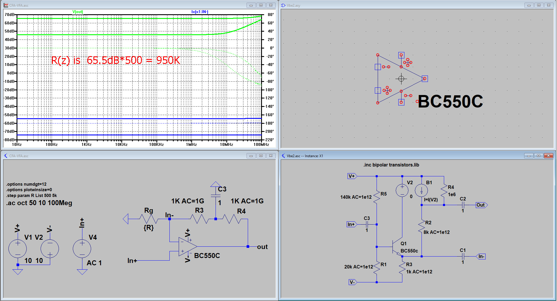

We must certainly live in parallel universes. Draw the schematic after breaking the loop and see what you get. Read any application note about the CFA closed loop gain, for example http://www.ti.com/lit/an/sloa021a/sloa021a.pdf and check out the closed loop gain at pp. 3-4
To add insult to injury, if Rg||Rf=1k and Rf=1k then arithmetic says this is nonsense, something like 0=1, or Rf/Rg=oo
Parallel universe is certainly the most likely explanation.
Can you show me where I wrote Rg||Rf=1k and Rf=1k please ?
Anyway, as Scott says, there is no Rg. Rf = 1k , closed loop gain is ~1.
Same is true of an H-bridge VFA with 1k degeneration (very little expansive action).
Yes of course that is true, but I would never recommend doing that. It will destroy the performance and add noise.

This make your position on bidirectional or unidirectional COD vs symetric or asymmetric CFA topology clearer.
Just use the test as it is meant to be.Thank you Hans,
I have questions/comment on your setup :
- a VFA with a resistor connected to the 2 inputs is detected as a CFA.
- how to conclude on the feedback operation mode while the DUT is in open loop ?
Insert a circuit without any form of external feedback or resistors between the inputs.
All and nothing else it will tell you, whether this circuit has a CFA or a VFA topology with a high probability.
See below the outcome of a test with a single transistor. Has it a CFA topology in this setting ? The test confirms this with a yes.
Is therefore every transistor in every application a CFA ? Of course not.
