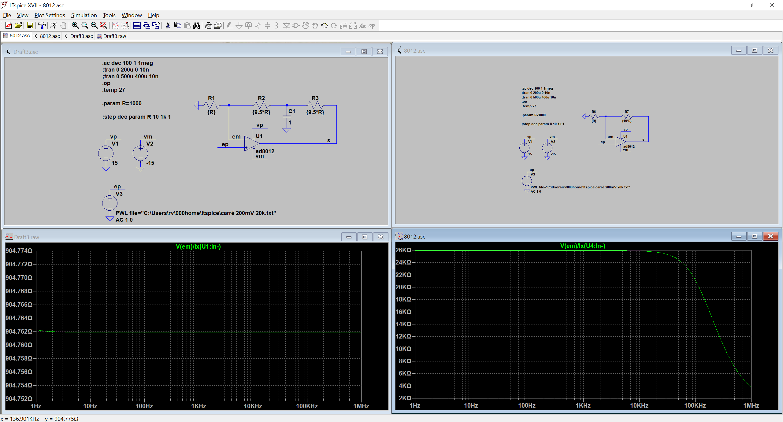

The negative feedback loop has the strange property to bootstrap the load of the inverting input with the effect of decreasing its AC current amplitude. Otherwise said, there is a hidden positive feedback in the loop.
As can be seen on this example, the negative input closed loop impedance is more than 20 times the impedance of the feedback network.

Your question can be turned: why the low Z inverting input does not load the feedback network ? To me, it is a fundamental question, it made me to come back to this thread :
As mentioned before, it appears you are slowly discovering how feedback really works! One more hint: the difference in signal between +Vin and the -Vin input is exactly Vout/Aol.
