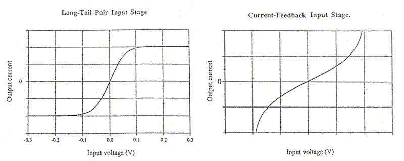

If you look at the page you are liking to you find the text that you have copied and two diagrams.
"As expected, the CFA is here 5 time faster than the VFA. And this is not due to the miller cap, but the input stage topology: the way the feedback signals are substracted from the input ones.
This is due to the two input stage topologies transconductances: The Long-tail Pair is "compressive" while the CFA is "expansive" (© Richard Marsh).
In other words, think about the "current on demand" behavior of the CFAs, too well described in numerous papers to be pontificated here ;-)"

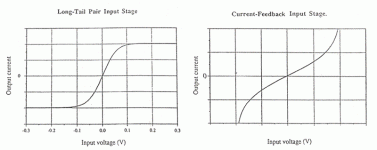

I have attached the diagrams.
The diagram on the left is showing the I/V transfere function of a LTP inputstage. It shows how much current you will get out depending on the input voltage, on the right diagram you see the transfer function of a Diamond inputstage.
You can see that for a LTP you will not get more current out even if you increase the input voltage, when you have passed a certain level, but for the diamond the current will increase with increasing input voltage and at a certain input voltage the current will will increase extremly. COD
As you know an H-bridge inputstage in this context are two diamonds and will have a sinh transfer function.
I hope this was understandable.
