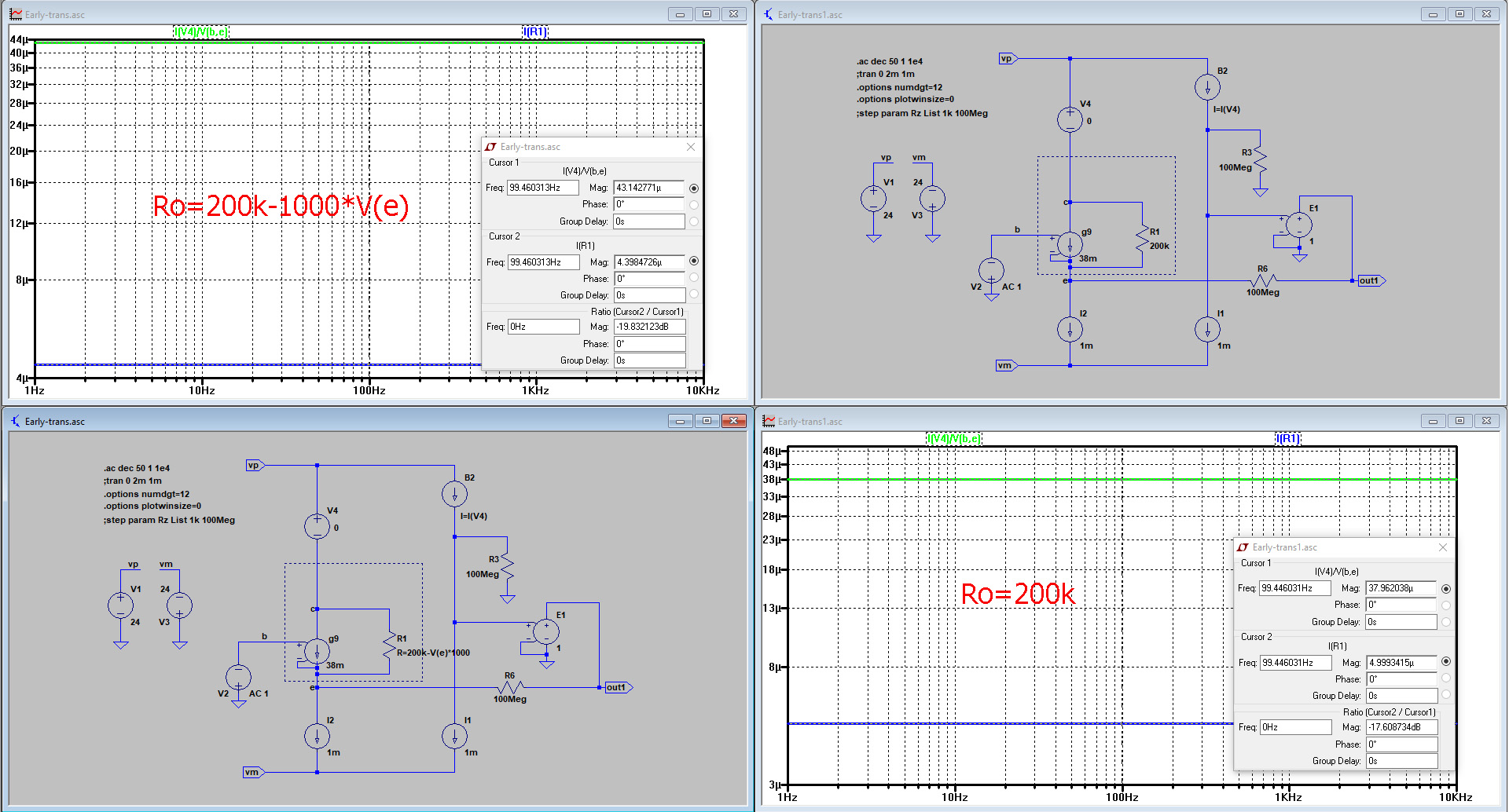

Hi Ian,
You haven't responded so far on my posting where I mentioned that using a 200K Ro was less correct, because Ro changes with alternating input voltage, in this very case between 199K and 201K with Vin=1V and Ic=1mA.
Instead of +/-5uA, current through R0 only changes by 4.4uA.
In the model below I have both versions, one with a fixed 200K resistor and the other with a correctly fluctuating resistor value.
AC current as can be seen in one model is 5uA and in the other 4.4uA.
Difference in ic/vbe is not that big, but it is simply more correct to my opinion.
Hans
