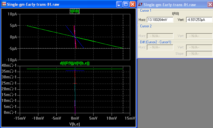

: Originally Posted by IanHegglun
My analysis assumes voltage control of the input transistor (Ic=gm*Vbe) and the current flowing through Rf is entirely the input transistor emitter current which flows from emitter to output. .....So I don't see any indication of "current feedback" using these equations, nor that the Early effect upsets voltage feedback as the controlling mechanism. Or have I looked at it the wrong way?...
Surely we can agree that current is being fed from the output through the feedback network back through the transistor into the heart of the circuit. And if we wish to consider an Rg with the Rf, Hierfi pointed out that the circuit would operate virtually identically if the Rf / Rg feedback network drove a unity gain buffer which drove the inverting input through an Rg || Rf resistor..
I'm sorry but I can't agree with you on this because I can't see any current feedback in this circuit with no Rg -- the current through Rf is flowing the wrong way for feedback. We think of CFA feedback current from the output to the inverting input (with a positive input). But not so in this circuit.
With an Rg you can get the current direction to reverse through Rf. But how does this introduce current feedback to this circuit? Just because current is flowing through Rf from the output does not mean we have current feedback because current flows through a VFA's Rf feedback resistor too but we don't call that current feedback. We have to be consistent in both cases to be consistent🙂.
Middlebrook's Double Injection Technique verifies that significant current feedback is occurring along with voltage feedback at the inverting input, sustaining this viewpoint.
The DIT does not differentiate between CFA and VFA -- it is just your interpretation of the DIT values that gives you that viewpoint.
This Early effect discussion was introduced simply to point out that the transistor is not acting as a perfect transconductor, and that there is a resistive, non-(voltage-controlling) transconductive path for current to flow from the inverting input to the low impedance current mirror input
I found the current through the 'ro' is a local current loop from the gm source only with a constant peak current of 5uA for 1V input (ro=200k). It's current does not change with the loading on the mirror which changes the feedback loop gain. See attached plot (R8 is the Early ro resistor). So no indication that this restive part is affected by changing the feedback loop gain. An "imperfect" transconductor does not support the possibility of current feedback.
The analysis I used with a pure transconductance with only voltage feedback gives the correct rations (thanks Hans) for Ic/Vbe in the presence of an ro restive component.when the feedback loop gain is varied by Rz ... and with no Rg for a unity voltage gain CFA..
I also conclude that only the old style voltage feedback taking place in this circuit. Therefore the CFA name is a misnomer for this circuit.
IH

Ian,
To my opininion there is still one thing in your very nice calculation that is incorrect, being the use of Ro.
The way you treat Ro is as if Va is 0 Volt.
But 200K with 24V supply means a Va of -176 Volt.
So when changing the voltage over Ro with +/- 1 Volt as in your Sim, current does not change +/-5uA but only by +/-0.6uA.
Hans

Hans,
Whatever Va value, a variation of +/- 1V applied on 200k gives a current variation of +/- 5µA.
Hans,
That's an open door, but it does not apply to this situation.
But I made an error in my previous posting. Current does not change from +/- 5uA, to +/- 0.6uA, but to 0.6uA less being +/- 4.4uA.
Let me try to explain.
Ro=(-Va+Vce)/Ic.
Ic=1mA, Vce=24Volt and Ro is set at 200k.
Hence Va=-176 Volt.
When Vce becomes 25 Volt, Ro= (176+25)/1e-3= 201K.
Current through Ro becomes 25V/201K=124.4uA and not 125uA, so it is 0.6uA less as with a fixed 200K resistor.
Hans

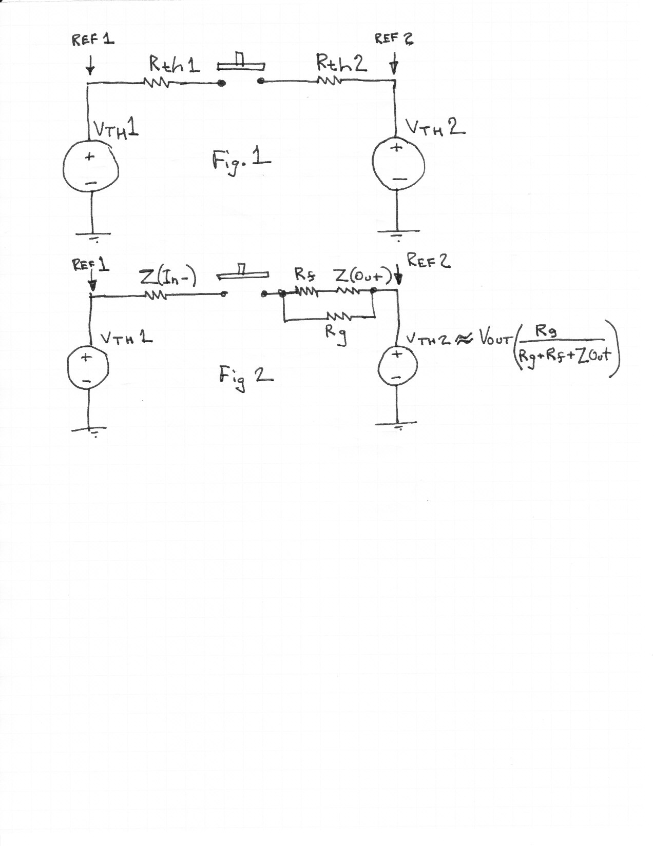

Ah... do you mean by authoritative as pointing to someone other than just me? Ok... in that case no. It seems I must now resort to argument as opposed to "appealing to authority"... dammit (oops... excuse my language).
Thevenin's theorem translates a network into a voltage source connected to an open circuit resistor.
Thevenin's theorem - Wikipedia
Figure 2 shows the resistance elements attached to the two V Thevenin sources prior to connection. The value of V Thevenin 2 is shown as a function of Vout, that in a previous post was shown being included in a visual Thevenin translation that could replace the Rf, Rg feedback network.
From the perspective of Figure 2 there is no relationship of the value of VTh2 to RTh2 other than a greater or lesser drop between VTh1 and VTh2. This is to state that the division ratio of RTh1 and RTh2 remains constant independent of gain, hence feedback isn't relevant in the determination if a CFA is a v.f. or c.f. amplifier. It is thought that the relationship of RTh1 to RTh2 are the only terms relevant, being measurable independent of feedback.
With gain, all that changes is the magnitude of the voltage drop across VTh1 and VTh2. Hence the term "feedback" isn't relevant if it is irrelevant of gain. This is under circumstances identifying a device c.f. or v.f. device. This leaves us with "CA" as even more confusing if we drop F in the mnemonic. By the way, current limiting feedback doesn't work either by such reasoning. For want of a better term it seems that CMA isn't all that bad.
