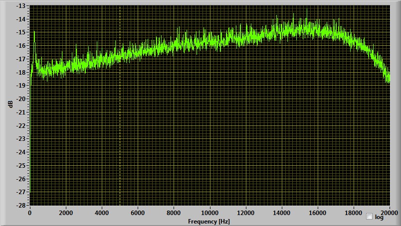

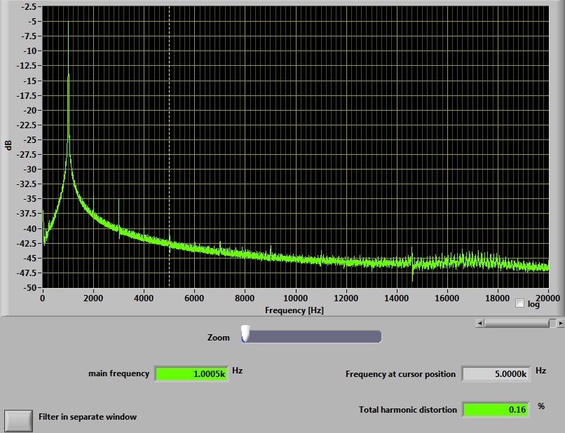

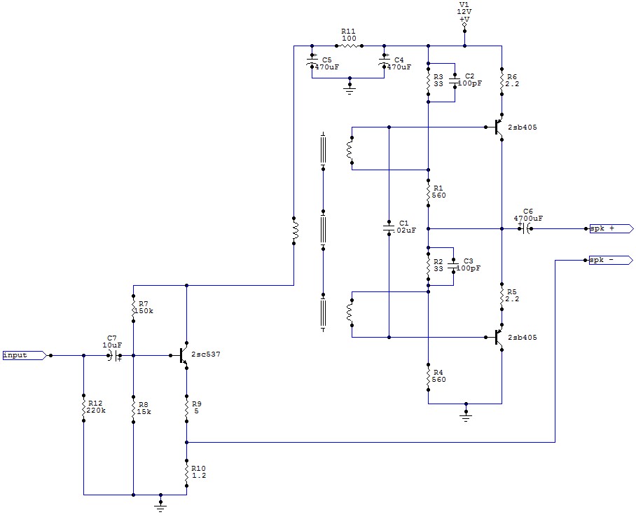

Just sharing my desktop amp since it's on topic here. Repurposed from a late 60's Sears under dash 8-track. A few small mods and this little amp became extremely enjoyable to listen to.
Measurements were taken with the speakers as load not a resistor. Easily spotted is the peak at 240Hz, the resonance of my speakers.

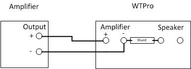

I'm not sure if we can use a simple resistor in the earthy lead of the speaker to get Current Drive with WTpro. I think you said WTpro current measurement required a resistor to earth.
Can you post a sketch of how you connect your supadupa current source amp with WTpro?
The WTPro has a shunt to ground. If a chipamp is used in a grounded shunt configuration, the signal across the shunt can be buffered and brought out to replace the shunt used in the WTPro. The WTPro shunt is mounted outside and is removable.
If a Howland current pump is employed, there will be two shunts in the system which will wast a little bit of voltage swing but no big deal in the grand scheme.
Woofer, I sent you a PM asking for your email address. I'd like to send you a draft proposal for a WTpro Transconductance Amp using ChipAmps.

To avoid the sensing resistor being connected to ground, Merilainen suggests (in his book pp 190-191) to insert it between the power amp output and the load, the voltage across it being sensed by an op-amp (NE5534) in differential mode. The output of this op-amp is connected to the inverting input of the power amp and a Zobel RC is added across the load.
That is on my list of things to try. Do you think it practical to develop a box to implement the idea you describe? You could use the box with any generic amp to make it force current.
