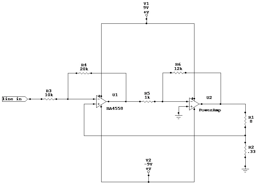

I think I found the noise problem. It is digital noise from the signal generator. The gain of this PCB into 10 ohms is 300 which is much too high. The transconductance of the amp is 30 A/V. A value of 2 would be much better
This looks elegant. Is the output inverting with respect to the input?
Output is not inverting.
Can you post the original schematic? And model number of the amplifier?
Model no. 12-1971A These pop up on ebay all the time. 2X50Watts@4ohm. Attached is the schematic that I manually traced, no schematic that I have found available. There is a bill of materials for this model number on radio shacks archive ftp, But I found none of the semiconductors are the same as in my amp. The driver and output semi's aren't correct in the schematic, using the closest I could find to sim, have to open it back up to see what the originals are. I changed only the opamp section by removing/changing a couple of resistors and adding .33 5watt resistors between spk out ground terminals and pc board and 4 jumper wires.

Thank you very much for posting the original schematic.
I definitely do not understand the change nor the original.
In the original version, the audio input is applied to the + terminal of the opamp and the opamp drives LTPs at where the amplifier feedback is connected.
The modified version has the audio input on the - terminal of the opamp and the current shunt feedback is applied to the + terminal of the opamp.
I am definitely not following either original or the modified amp.
A simplified way to look at it. The concept works identical to the My_Ref Fremen Edition amp that is discussed in the chipamp forum. This can be optimized quite a bit more but I didn't want to make any alterations to the pc board.
Thank you for the explanation. Is the original, un-modified amp inverting?
Yes it was, which I thought was odd.
Thanks. That threw me off initially. Now it makes sense.

Using it as my PC sound at home with a 300watt ATX supply. It drives an old pair of magnavox 2-ways, sounds nice, clean and detailed. Would never suspect the outputs are biased right at the class B/AB threshold, voltage drop across the .22 emitter resistors only a couple millivolts. Now if I could find my other 1k 10-turn I would mod the bias circuit, I know its around here somewhere.
hitsware, this is a non-bridgeable model, probably the base model of models for Radio Shacks car amps from this period. The outputs may survive a brief stint at 2 ohms but the drivers would surely smoke, they are the oversized to92 looking package.
(edit) pulled the bottom cover to get numbers on drivers/outputs- driver 2sc2235/2sa965 outputs Mospec BD907/908
