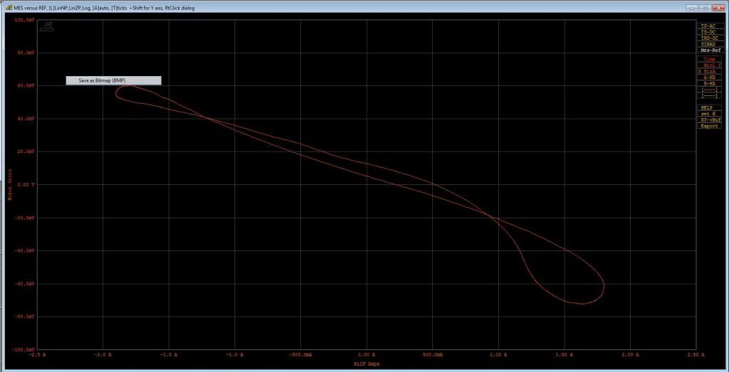

Using the WTPro X-Y mode I plotted a suspended mic above the woofer vs current in the voice coil. The slope of the plot should be proportional to BL. Here it is

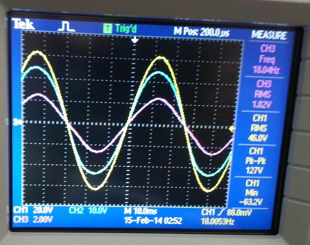

That's a hell of a bass unit with 4" p-p excursion. What is it?The scope shot posted at 36V is just about Xmax; 3 to 4 inches p-p. The following scope shot is about 1/2 of that drive, 1.5 amps at resonance:
Is the new scope pic showing about 1.5-2" p-p excursion?
Which of the 3 curves on the scope is the wonky one? The other 2 are sorta clean.

The woofer is a Tantric Sounds HD 12".
Tantric SubWoofers
It was made for me for the purposes of creating a reliable way to test BL at Xmax as well as measure excursion reliably.
The new scope shot is 1.5 amps RMS. It is about 1/2 of Xmax. Probably a bit less.
The wonky curve is the current in the driven voice coil. At 37.4 V rms drive the current in the voice coil is about equal parts fundamental, H2 and H3.

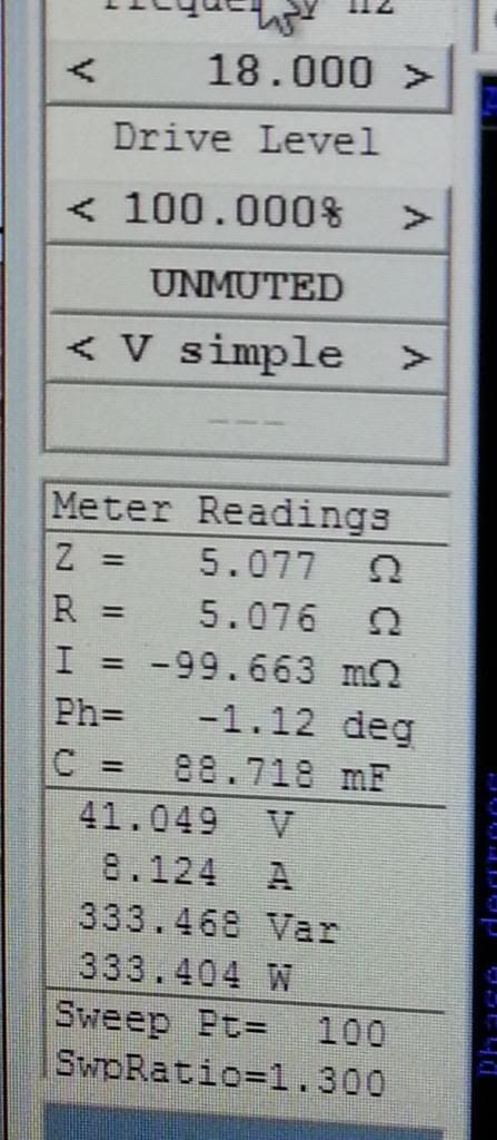

Interesting experiment and results.
One coil is loaded with a 0.25 ohm Caddock non inductive power resistor.
Amp is turned up to maximum. Freq is adjusted for Fs. Results below
Zmax drops from 12 ohms to 5 ohms. Onset of clipping is over 300 watts. I can get to 350 with careful adjustments. Check out the current into the speaker, 8 amps rms.
Scope shows that current distortion is essentially gone.
Power into resistors is 13 watts. The coil is 2.2 ohms-ish. Power developed in the shorted coil would be 116 watts.
Excursion is high but not at Xmax.

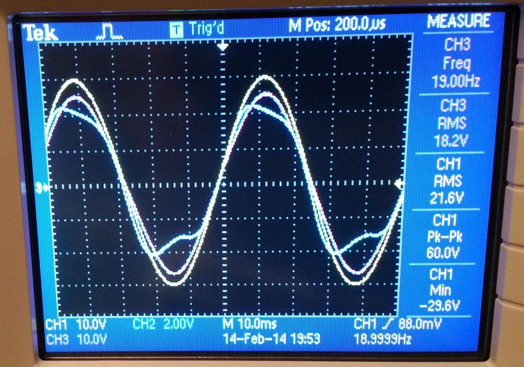

In the scope shot below, yellow is the voltage driven to one coil of a DVC woofer. Blue is the current in the driven coil. Purple is the open circuit voltage of the un-driven second voice coil.
Firstly, for expediency, please let me refer to the two voltages of the Dual-Voice-Coil (DVC) driver as follows:
Vd (drive voltage) = the voltage applied to the driven coil (yellow trace in the scope picture above)
Vs (sensed voltage) = the voltage measured from the open-circuit (unloaded/undriven) second coil (purple trace above).
My questions are:
Q1) What or why is the difference between Vd and Vs? In other words, what causes the voltage difference Vd-Vs? Or, what does this voltage difference represent?
Q2) The sensed voltage Vs (purple trace - the voltage measured from the unloaded second coil) looks somewhat distorted. What is the cause of this distortion in Vs?
[Any comments towards answering these questions will help improve my understanding of the present topic: current-drive of loudspeakers. Please note that I am not an expert in audio or loudspeakers, and I am still reading about "current-drive" albeit in bits and pieces, if or when I find some - the always elusive - 'spare-time'.]
Regarding Question 2 (i.e. the distortion in the sensed voltage Vs), I notice the following:
When the drive voltage Vd is reduced (so as to produce ~ half of the maximum excursion, as I understand from Woofertester's message #181), the distortion in the sensed voltage Vs disappears almost totally. Please see the purple trace in the scope picture below (from message #181).

Firstly, for expediency, please let me refer to the two voltages of the Dual-Voice-Coil (DVC) driver as follows:Vd (drive voltage) = the voltage applied to the driven coil (yellow trace in the scope picture above)My questions are:
Vs (sensed voltage) = the voltage measured from the open-circuit (unloaded/undriven) second coil (purple trace above).Q1) What or why is the difference between Vd and Vs? In other words, what causes the voltage difference Vd-Vs? Or, what does this voltage difference represent?
Vs is the back emf produced by the open coil #2. This voltage equals BL times cone velocity.
As stated above, this voltage is BL times cone velocity. BL is non-linear. The suspension is non-linear. So, the cone velocity is going to be nonlinear driving a non-linear BL in the reverse direction.
[Any comments towards answering these questions will help improve my understanding of the present topic: current-drive of loudspeakers. Please note that I am not an expert in audio or loudspeakers, and I am still reading about "current-drive" albeit in bits and pieces, if or when I find some - the always elusive - 'spare-time'.]Regarding Question 2 (i.e. the distortion in the sensed voltage Vs), I notice the following:
I suspect that the non-itineraries are much smaller than at Xmax.
Nevertheless, as evident in the picture above, there still remains a voltage difference between Vd and Vs (which are now fully in phase).
Besides, as can be seen from Woofertester's message #191 quoted below,
when the sense-coil is loaded with a 0.25 ohm non-inductive resistor, the magnitude of Vs reduces considerably (as expected, since the sense-coil is effectively almost short-circuited). In this case, the sensed voltage Vs (purple trace) is not distorted and is still in phase with the applied voltage Vd (yellow trace). Obviously, shorting of the sense-coil exerts a large amount of damping on the motion of the (total) voice-coil in this voltage-driven case.
I am not bothered too much about this particular case (presented in message #191). Because I am trying to understand the relationship (if any) between the voltage difference (Vd - Vs) and the current (particularly its waveform) flowing in the driven coil (blue traces in messages # 168, 181 and 191).
Thanks for reading this far.
the current in the drive-coil (blue trace) is still highly distorted (although not so much as in the maximum-excursion case). Nevertheless, the sensed voltage Vs (purple trace) has quite an undistorted waveform. WHY? Isn't there the transformer action, i.e. mutual coupling, between the two coils? How come does the highly-distorted current in the driven coil NOT affect the voltage induced in the second sense-coil?
Besides, the magnitude difference between the drive voltage Vd (yellow trace) and the sensed voltage Vs (purple trace) seen in the scope shots still remains unexplained.
Thank you for your attention.
