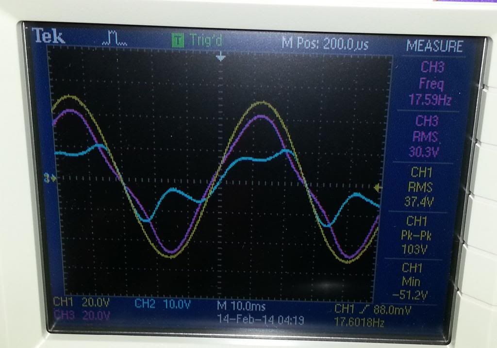

Actually true Current Drive exacerbates 'mechanical resonance issues'.I see potential in a true current drive, as it has the potential to override some of the mechanical resonance issues of modernday voltage driven speakers and drivers.
ie if a speaker has a mechanical resonance problem, it will be even more obvious with true Current Drive. This is not a Golden Pinnae thing but easily heard on a sine sweep.
In the scope shot below, yellow is the voltage driven to one coil of a DVC woofer. Blue is the current in the driven coil. Purple is the open circuit voltage of the un-driven second voice coil.
There is about 3A RMS forward. The speaker is about 12 ohms at resonance.
I had thought that the driven current distortion is due to the phase of the back emf. It appears I was wrong. It looks like back emf distortion may be the culprit compliments of the non-linearity of BL.
The back emf is non-linear and asymmetric.
The The driven coil current distortion is quite visible at 1.2A rms.

Thats looks like an accoustic mixing from cabinet and mass effect.The back emf is non-linear and asymmetric.
E: Mass effect should be forced to be minimum, and accoustic mixing should be allowed as it is, thats something difficult driving. It most difficult is in HF.

The woofer is suspended in free air. It is operating at resonance. When I adjust drive level, I adjust the frequency for speaker resonance.
Woofer, this is a very high level 36Vrms at resonance 😱In the scope shot below, yellow is the voltage driven to one coil of a DVC woofer. Blue is the current in the driven coil. Purple is the open circuit voltage of the un-driven second voice coil.
How much is the cone moving (+/- ? mm) ?
Can you do another scope pic with the cone moving at Xmax and another at 1/2 Xmax?
