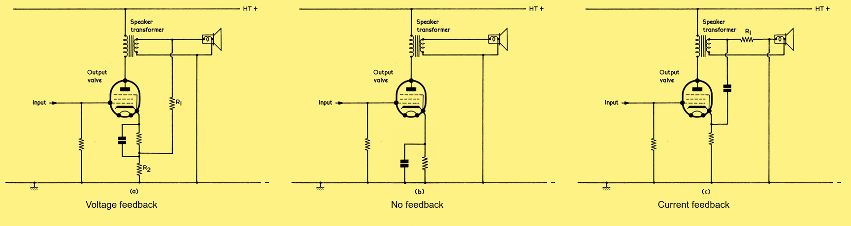

This is mostly speculation since I have not built this.
Due to less distortion, current-drive would be already widespread if the bass resonance of a conventional speaker did not spoil that. However, solving the resonance issue may bring the current-drive to markets. This probably means some kind of an aperiodic loudspeaker, and there are many possible aperiodic speaker designs. But I won't get into details. Instead of explaining reasons leading to current-drive, I concentrate in the amplifier. I started thinking, how would one design a current-drive valve amplifier.
I approach the idea with a drawing. I borrowed some graphics from W. G. Morley.
(a) A voltage feedback circuit is a good starting point. The feedback may be brought to the cathode of the output valve, a pentode in this case. Resistors R1 and R2 are there for feedback only.
(b) A pentode left without feedback is actually a kind of transconductance amplifier, but not very good one due to distortion. Otherwise it is nice and simple.
(c) A resistor is required for current feedback, so it must be series connected with the load. The amount of feedback may be adjusted by choosing the resistor.

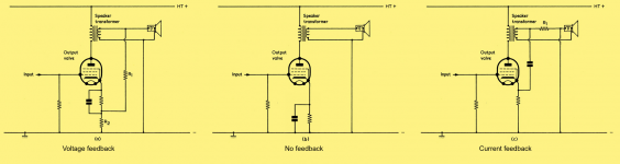

I've often thought that current drive should be used in combination with motional feedback. To my mind it is the same principle as a current mode SMPS.

That is a good observation.
I believe that there were audio current sense feedback amplifiers in the 50s, if not also in the 40s. If I remember correctly, that was for controlling the woofer impedance effects and woofer mechanical resonance.
Of course, your idea is different than that.
A typical full range driver has at least one resonance in the bass, or 2 for ported, etc.
It also has a rising impedance at mid and high frequencies due to voice coil inductance.
All of these problems can be overcome with LCR Zobel networks, and other RC networks.
All of these solutions suck up power.
A typical two way loudspeaker has another resonance at the crossover from woofer to tweeter. A Zobel LCR network solves that, but sucks up power.
When a loudspeaker designer chooses a solution, in his mind might be the answer to a question: What is the customer going to use this speaker on, a solid state amp (voltage output amp), or a vacuum tube amp, or a current output amp?
Since there are so few current output amps, he might not design his loudspeaker for that.
Now, of course an experimenter, a hobbyist, or a designer, could design both loudspeaker and amplifier as a system.
I have never checked the impedance versus frequency of a Magnepan speaker, but I believe it to be quite flat, except at the crossover from woofer panel to tweeter panel.
It is low impedance, and takes lots of power. But it is probably one of the flattest impedance curves out there, and does not require Zobel network, but could use one at the crossover frequency.

TonyTecson,
I think that Global Negative Feedback for many tube amps is often taken from the output transformer tap (the tap that goes to the loudspeaker).
The voltage is fed back to an early stage as negative feedback.
With a test generator constant sine wave, or a long flute note,
If the loudspeaker is high impedance, the voltage goes up.
If the loudspeaker is low impedance, the voltage goes down.
The global negative feedback does its best to keep the voltage constant.
That is a Voltage feedback amp.
Another way to look at it, if the loudspeaker current is great, the voltage goes down.
if the loudspeaker current is small, the voltage goes up.
The resultant voltage is fed back, resulting in a constant voltage out, to compensate for the load current.

No.
There are no-NFB Pentode amps in kitchen radio and guitar amplifier traditions. High output impedance, OTOO 10X the nominal load.With proper choice of loudspeaker these may be "pleasing".
When we want "good" reproduction we pretty much go to "more triode-like" which means voltage feedback to get a low output impedance.
In the 1950s there were a few amps with "variable damping", from 3Xload (more current feedback) to 0.1Xload (more voltage feedback). But with mass-market loudspeakers this is always a compromise.
Nelson Pass has also written on current drive.
non feedback types do not count....
with tube pp amp with negative global feedbacks, CFA is the one where feedback is fed t the cathodes which is a low impedance point in comparison with the grid which i very high impedance as in VFA type....
...CFA is the one where feedback is fed t the cathodes which is a low impedance point in comparison with the grid which i very high impedance as in VFA type....
Uh, that may be another thread. Nikolas is clearly sensing LOAD (voltage or current). It happens that his sketches show NFB to a cathode but that does not matter to the load. You were following along, I thought, when you mentioned a resistor (I thought, to sense load current).

The problem is that the term current feedback has at least three different meanings. In this thread it is used in its original meaning: series feedback at the output to make the output impedance high.
