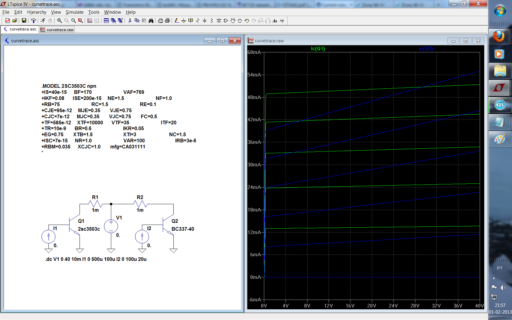

Dado have you measure your circuit in real life ? Simulations are only as good as the models we use , i tend to use bc327 and bc337 because they give me results close to the reality, if you use the models 2sa1381c 2sc3503c from bob cordell you will have very good distortion results in sim , but not so good in reality.
Early voltage changes with operating point. Some transistors even have a negative early voltage at specific operating points. So perhaps Cordell's model is a compromise. Furthermore, perhaps the 2SC3503 and KSC3503 are not very similar in this respect?
curves from 2sc3503c from bob cordell (green) and bc327 (blue), if you use 2sc3503c in sim you will have much better results , but this transistor is very good , it has a hight early voltage and low noise, but low Hfe , i like it very much , but i think the models are not correct.

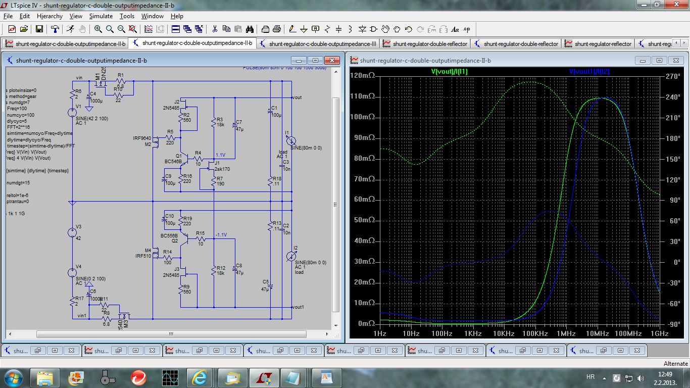

Here is new shuntreg simulation. I am trying to keep just one jfet ccs as in this case output voltage adjustment is possible with one trimer(R7 in this case). Here CCS voltige is 2.2 V and I think its on safe side of the knee(in saturation region).
dado

But A and B perform the same when you have 220/75 degeneration. Do you know of a better way to increase gain?

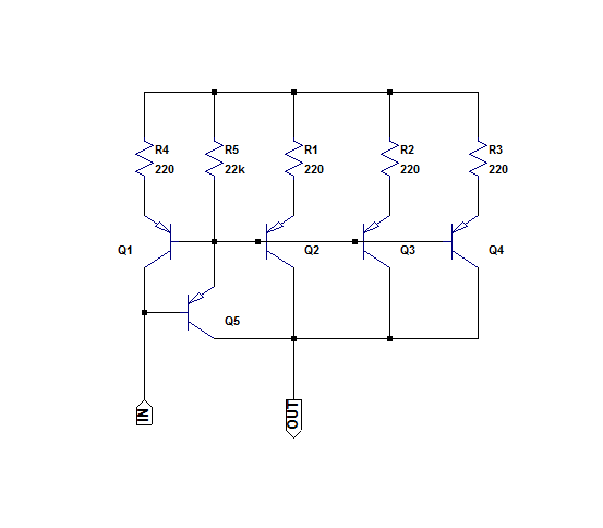

A 220/75 degeneration ratio will imbalance the mirror, and it will lose some distortion cancellation property.
one way to do the job without loosing balance is like this , the penality is adding 2 bjt and 2 resistors.

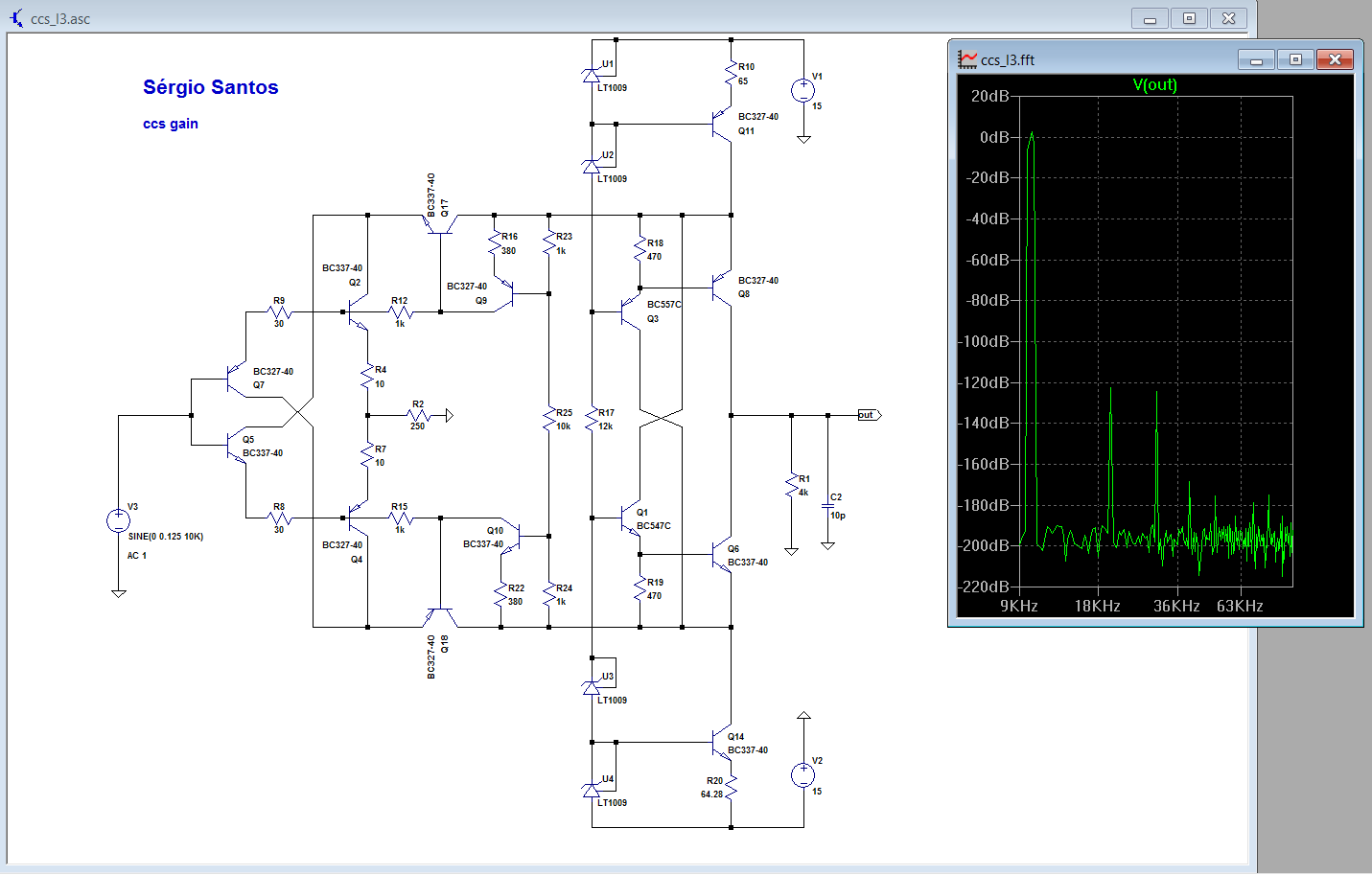

Here is a similar circuit but with current sources instead of current mirrors.
I cut some of the fats, to get it in accordance with Einstein 🙂
The distortion is 0.000069% at 4 V p-p with a gain of 16x
One of the advantages of using current sources like that is that the psrr is higher, I have made circuits with this topology with psrr of 80db.
