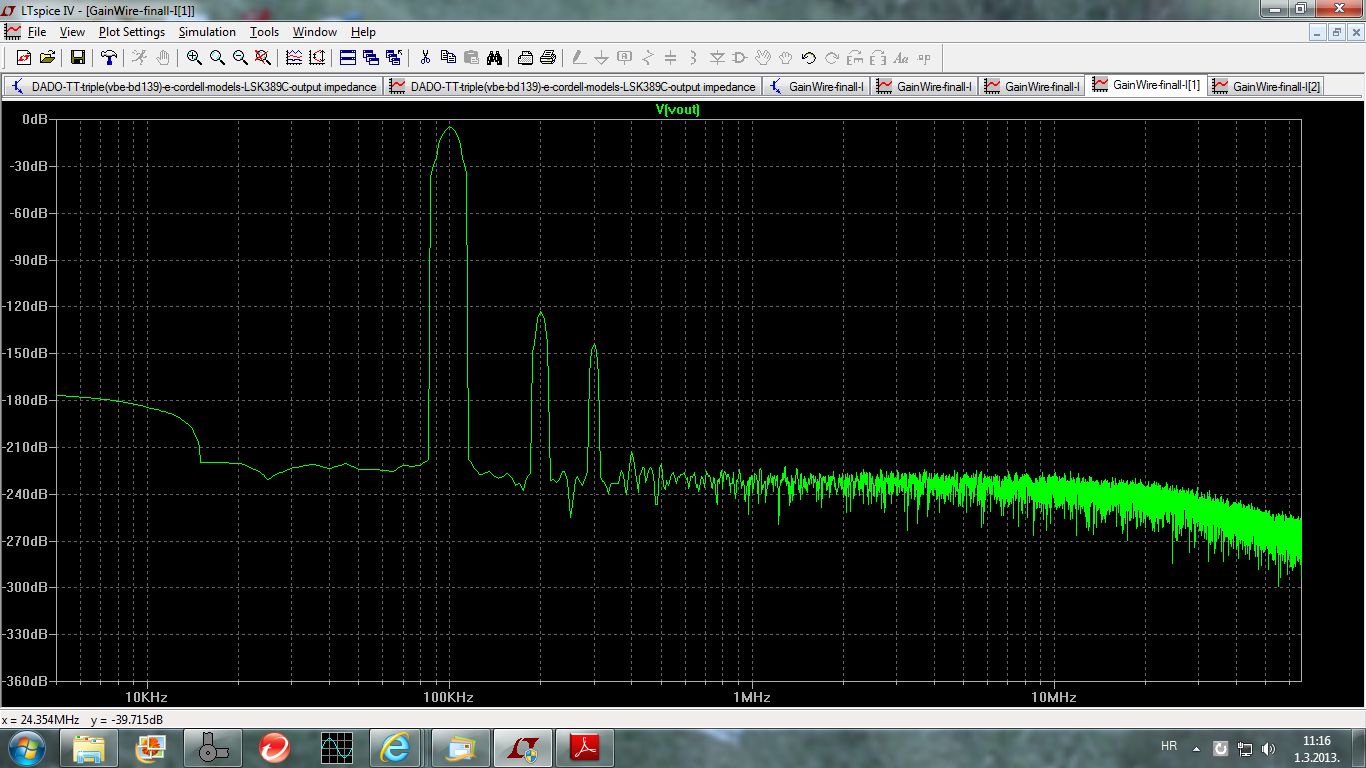

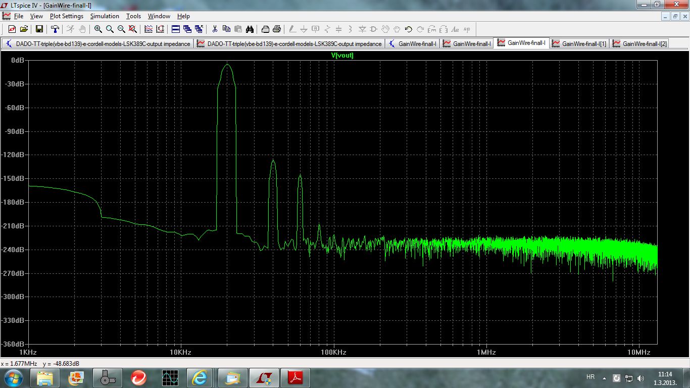

Discussion, in an other thread, about the need to have SUPER HIGH bandwidth was the reason to do some FFT simulation at 20kHz, 100kHz and 1MHz.
Here are the simulations only, I hope that the real result will be not far from it.
dado
dado

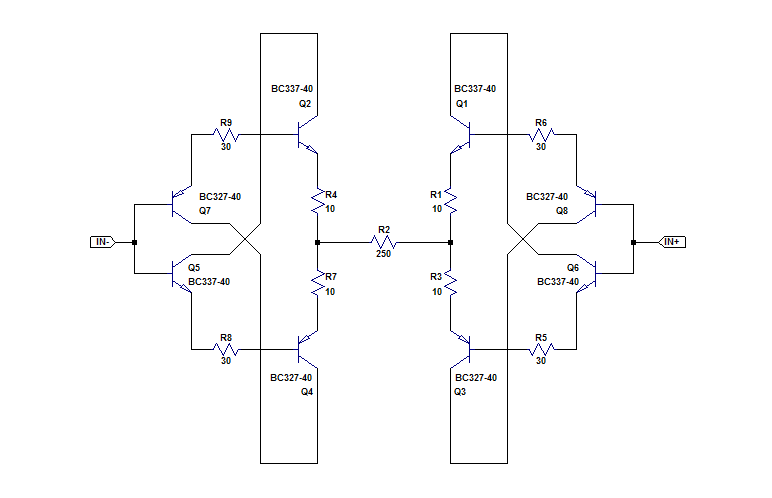

Sergio.. would it be possible to make something like the circuit in post #180 with balanced in..??
Will that also be possible to sum into a single ended output..??.. like for use with balnces out DAC's or for a balanced in pre-amp.
The outputs will be the sum ( of the differences) of the two inputs, If you need single end ouput just use one of the outputs and let the other unconnected .
Where do you want to use a circuit like this ? In a passive I/V converter ?
I Also have interess in this type of circuit , but is not a priority , for now I am just observing what dadod is achieving.
For the PCM 179x the output is differential. there the balanced in can be an advantage, also if one would like to make a flexible line stag where you would want both balanced and single ended inputs this circuit could be of interest. As earlier mentioned I see this concept strong, as i gets better spec.s as you reduce the gain. With a suitable output buffer it will be possible to make a Pre-amp/DAC with a non degrading volume control.

Hi Sergio
your circuit is oscillating
run sim at 1ns timestep
Pawel , erase C3 and C4.
That circuit was never built. is only a topology idea, not a finished project. So, use at your one risk 🙂
you were right,
how would you controll the offset and gain?
