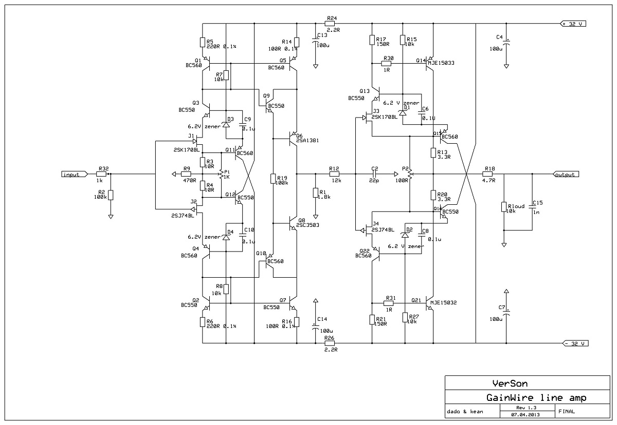

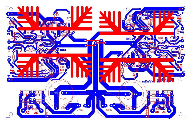

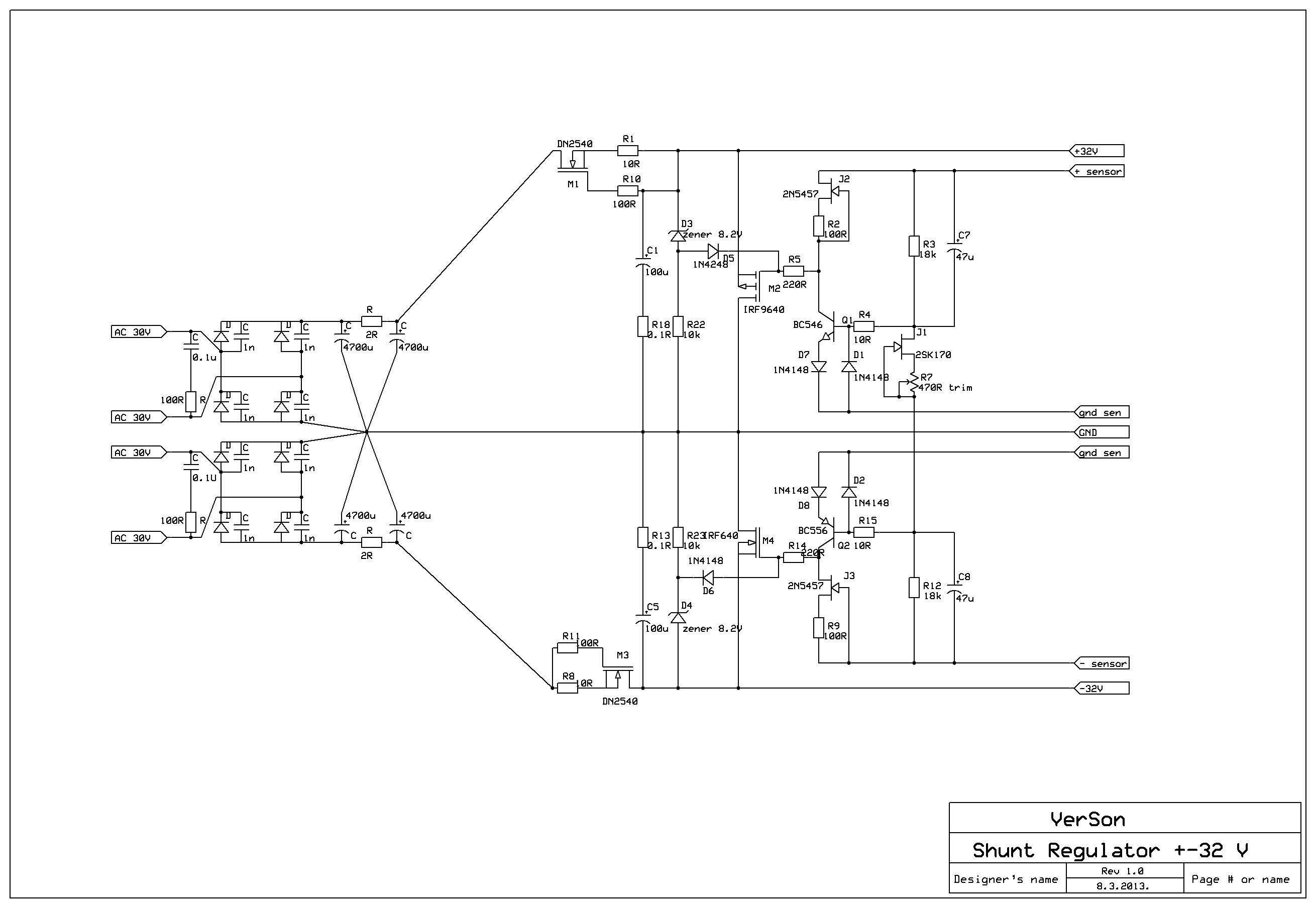

The shunt regulator was tested and adjusted to the +-32 V on both channels.Positive and negative output voltages are quite indentical and the adjustmen was done only with one trimmer pot per channel.
Here are the final circuit diagram and PCB layout. The circuit diagram shows one channel of the CCS - shunt part, and PCB was made with separate supplys for the stereo channels.

Yes probably, but could you suggest one to be used for 32V as a shunt.
And I will lose the feature of a simple adjustment both polarities with just one trimpot.
BR Damir
A series transistor with the 3-term shunt reg will keep the IC 3-term reg Ok to any voltage needed. Has anyone done this --- using two 3-term regs for a series/shunt reg circuit?
Thx-RNMarsh

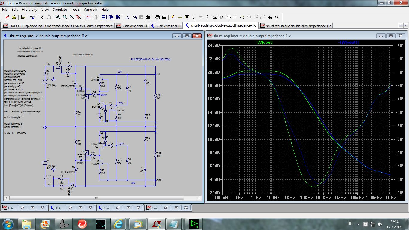

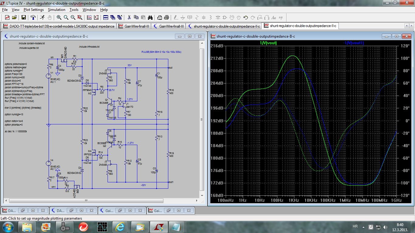

Sorry Bogdan, I was occupied with other things. Here is the shuntreg PSRR.
Because I did not find IRF640 model I used IRF530 model instead in the negative polarity, and that shows some small diference(probably).
Damir
I forgot to remove 1000u caps at the reg input, here is without those caps.
To get PSRR I change DC sources to AC sources with DC offset of 42V and make them AC1, then plot 1/v(vout).

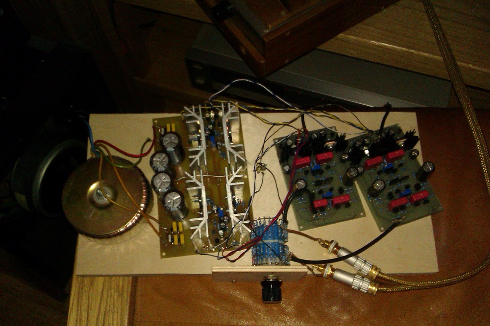

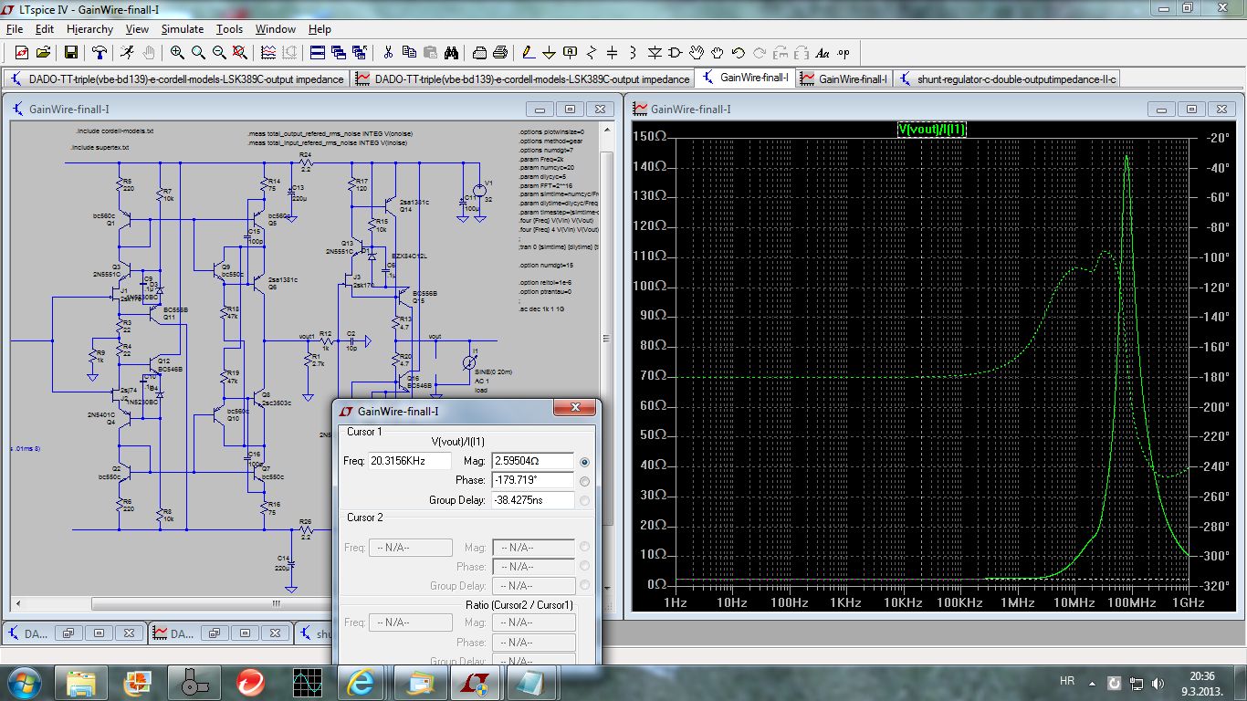

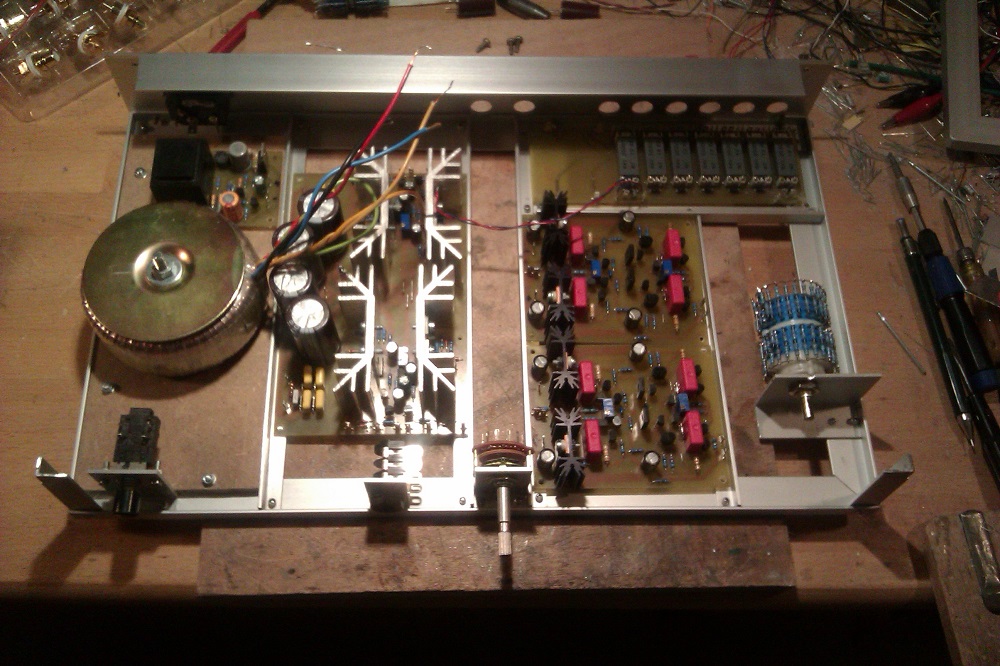

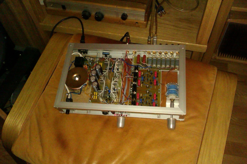

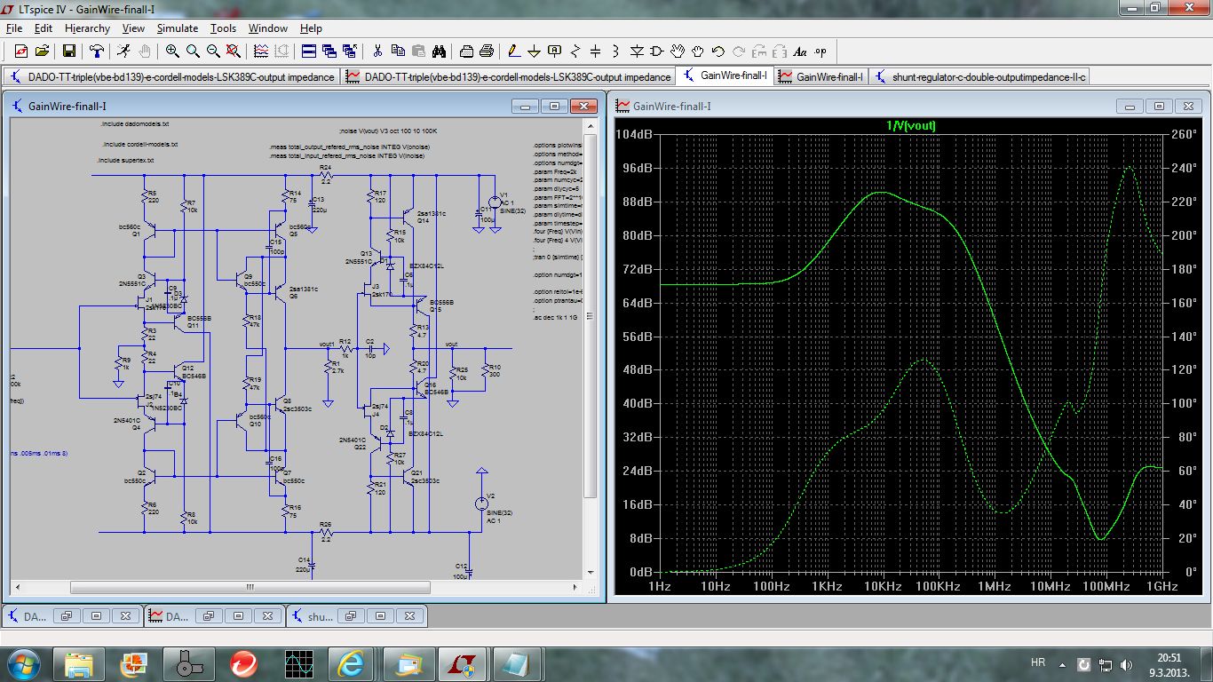

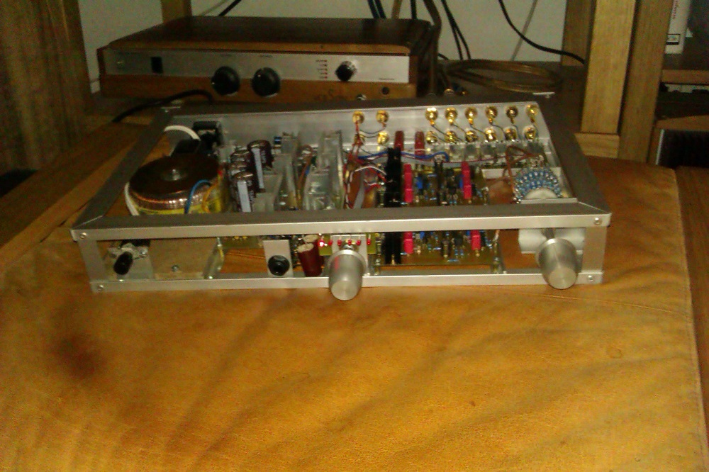

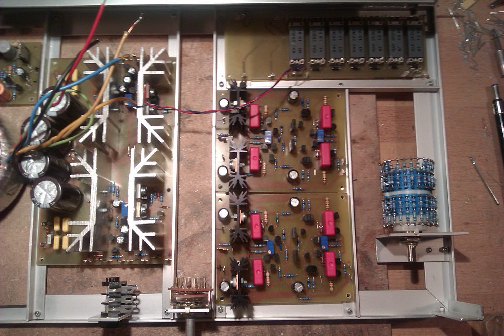

I am listening for a few days now this line/headphone amp and I am very, very satisfied with the music coming out of it.
The skeleton and the muscle are finished and now I have to put some skin around it. Final schematic is here and some photographs too.
BR Damir
