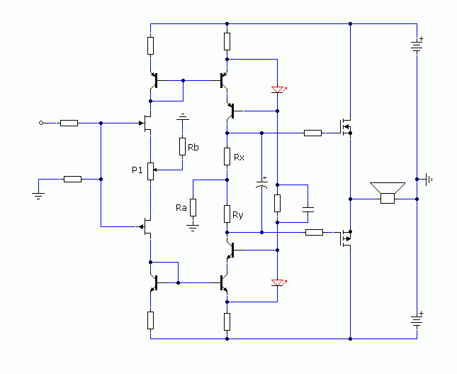

3. I would like to try a 0FB version. For that, I intend to build a FB and a non-FB board and try them listening just one channel. In your description, your instructions are clear regarding the changes needed. What is not mentioned, though, is where the wiper of the offset trimmer (P1) should be connected.

3.See schm. below and be patient when setting DC offset, it is more thermally sensitive without the feedback loop.
P1 still sets the DC offset. Relation Ra/Rb roughly sets the gain so for Ra=120R and Rb=1k you'll have about 20db gain.
Output bias current is set with Rx,Ry i.e. Rx=Ry=150R-220R (higher resistor value means higher current so start with lower values). Rx and Ry don't have to be equal - you can change the DC offset that way too, but it will change the bias current at the same time so you can experiment with that freely (but carefully).

Regarding the zero feedback version, I thought that the wiper of the offset trimmer should be referenced to ground, but my knowledge wasn't that specialized. So, your help was great in this matter.

Also, I must note that the amp was still supplied from my bench power supply. I believe that its sound will be much better with its own PS.
One thing that I also tried was to raise Iq to ca. 900mA, to check if I hear any difference. To be honest, I didn't hear any difference. So, since I have plenty of heatsinking (after 1,5 hours, the temperature of the heatsink had raised 16 degrees Celsius about ambient just next to the MOSFETs), I will leave it to the higher bias current.
One thing that I have noticed and which worries me is something I had seen since I was checking the Cubie2 on the bench: when I switched on the signal generator (which was already connected to the amp), I saw the DC voltage in the output going up to the full B+ and, in a couple of seconds, going back to the set offset voltage. I thought that this was a problem of the generator, whose output is DC coupled. Having this in mind, I connected it to my system without connecting the loudspeaker to the output of Cubie2, I switched on the amp and, then I turned on the preamp. Here I have to note that my tube preamp has an output capacitor and has a turn-on delay of ca. 30 seconds, with its output shorted to ground until the heaters are OK. What I saw was exactly the same: DC voltage in the output going up to the full B+ and going back to the set offset voltage within a few secs. What can I do regarding this? Of course, I could install an output protection circuit, but, since I had tried this previously on another SS amp, I noticed that it degraded the sound of the amp, since this circuit is in parallel with the output.
So, my next move is to build the other channel with zero feedback and do a comparison listening test between the feedback and non-feedback version to decide which one suits me best.
In comparison, I was listening back and forth to my "reference" amplifier, a 300B SE (built in monoblocks). Well, honestly, I could not tell a distinctive difference between the two. Maybe, the tube amp had a slightly better separation when multiple instruments were playing, but I cannot say for sure regarding this. If there is a minor difference, it's so minuscule that is not distinctive.
