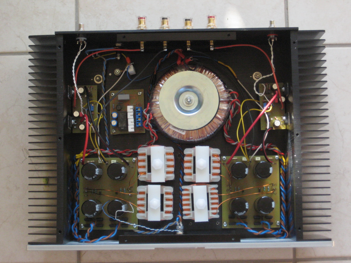

An update on my Cubie2.
After listening to the original (no feedback) version, a friend o mine, whose opinion I highly respect, suggested eliminating the capacitance multiplier stage and replacing it with a simple CLC filter. That idea was appealing to me.
So, just for a starting point, and to make things simpler, I decided to replace the MOSFET circuit with a power resistor of 2.2 Ohms, just on one channel, and make a direct A-B comparison. Well, I must say that the difference was huge! It was one of the rare occasions where I felt that a veil was removed from the scene. Suddenly, the soundstage was wider and deeper and the instruments were precisely put in the musical scene.
So, it was decided: the cap multipliers should go. In a second stage, I was inrigued to try the CLC filter against the CRC. For that, I wound two coils on EI75 bobbins, using 0.8 mm magnet wire and filling out the whole height of the bobbin (and a little more, since I wasn't going to use any lamination). This way, I produced two air-core coils with a resultant inductance of ca. 8 mH. I replaced two of the power resistors with these coils and made again an A-B listening test. The difference was not that huge as it was with moving from cap multipier to CRC filter, but, clearly, there was a difference: the sound was a little more defined with more air. Finally, I wound two more coils (my PS is dual mono) and, now, I must confess that my Cubie2 sounds absolutely fantastic!
Here you can see a picture of the final configuration.
So, Juma, thank you again for such a marvelous amplifier and for your help so far.

Thanks nash.
No, I haven't experimented with harmonics. FFT picture was taken at about 7W with P1 set to a value that nulls DC offset at the output.
My conclusions after similar comparisons are different: the coils improve bass and separation and fill up the vocals towards the lower midrange but make a dog's breakfast out of the highs. Whether the overall effect is positive is very system-specific.
In any case, thanks for sharing. It is refreshing to know some people here actually do listening tests and are not satisfied with just stuffing boards.
My initial impressions after listening to Cubie 2 for a couple of evenings - this is an excellent sounding little amp! 🙂
Last 2 years or so I was using almost exclusively my M2 clone, so it is easy for me to compare Cubie 2 to M2. Immediately after switching to Cubie 2 I noticed that it has higher gain than M2 (I had to turn volume pot down) and as expected Cubie 2 has less control in bass, which is quite good for my speakers. Cubie 2 is dead quiet, I never managed to completely remove a bit of buzzing (ear inch from the speaker) from my M2. In my opinion M2 sounds warmer and more "in your face", Cubie 2 is a bit drier, thinner, but also slightly more precise. Both are great amps, best I have built so far!

Just 25k stepped attenuator in front of Cubie 2.
I was lucky to get a couple of spare boards from diyaudio forum member...

Hi nash,
In fact, I'm also building an RT3C preamp, but I have left it unfinished for quite a while now.
Well, the purpose of the 2,2R resistors was to bring the output voltage approximately to the same level as the Cx circuit. Since the MOSFET drops about 4V and each rail of the amp draws ca. 0.9A, putting a 2.2R resistor in each rail I have a voltage drop of ca. 2 volts. This is a little higher than the Cx, but, if I was to drop 4 volts, I had to use 4.7R resistors, although with much higher power dissipation. Anyway, these were used just to make a direct comparison. The resistors were replaced by ca. 8 mH chokes.
I don't know which is the R6 resistor you are referred to. To be clear, I have left the whole MOSFET network out. Namely, my PS is a following: bridge, cap, choke, cap.
My transformer's secondary is 16 volts. With the Cx in, PS voltage was 16.5 volts. With the CLC filter, it is now ca. 18 volts.
Evangelos

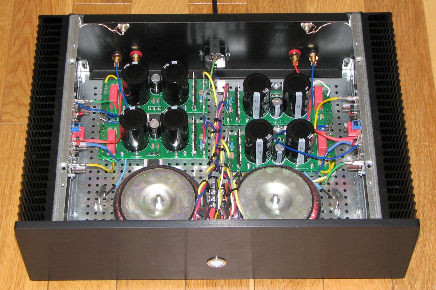

Build with the components I had for other projects that never saw daylight... It really rocks with my 94dB Cabasse speakers! 🙂
Juma, thanks a lot for such an incredible design,
All the best,
Berny
