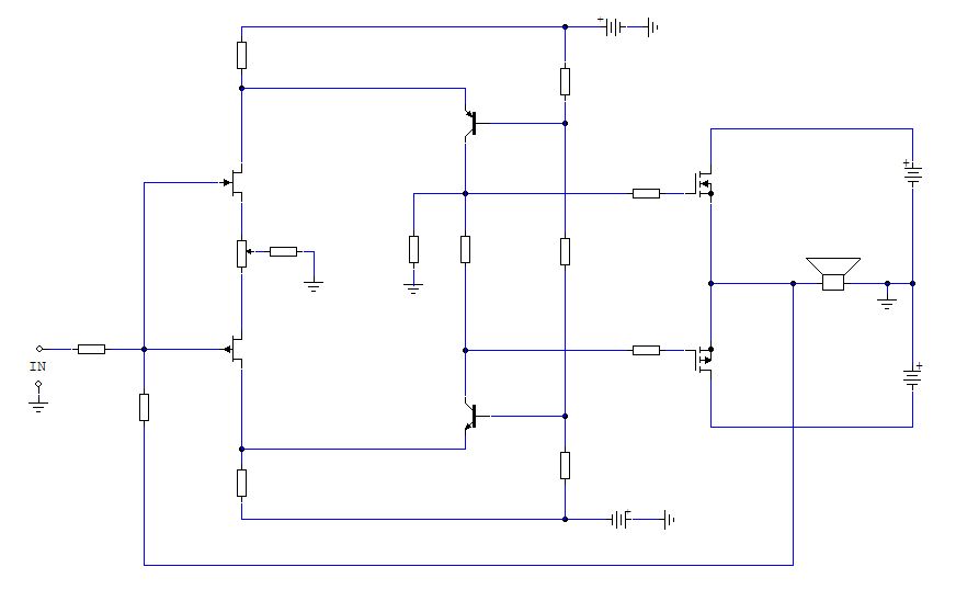

Yes, the circuit from BAF 2013 is really special and its worth an effort to turn it into power amp with enough gain and Zin high enough so that preamp is not needed any more.

It's easy to make different version of this amp (MOSFETs or VFETs in output stage, common source or common drain configuration, JFETs or BJTs at input and/or cascodes, etc.) which makes the field for experimenting very wide but let's say you want the schematic from post #199. Calculating the values is trivial if we put together what we already know:
- We want JFETs Id set at 80-90% of Idss. How much is that ? I don't know - it depends on JFETs you have at hand. They come in wide range so you got to measure them.
- JFETs' Vds can't be more than 25V but it can be less since we have common source output stage
- Cascodes need 5-10 mA flowing through them (let's calculate for 8 mA and small practical deviations won't matter)
- CCS carries the sum of currents through JFET and the cascode
- CCS needs about 5V to function properly
- Lateral MOSFETs need the Id of at least 0.5A (1A is preferable) to sound good which usually translates to Vgs of 1.5V to 2V (depending on parts you have at hand so you got to measure them)
- gain cell is a gm stage so it's good to give it some load in order to define its behavior
- amp's gain can be set in 15-30dB range, depending on your needs
- practical build will determine if you need some freq. compensation and how much of it.
So if we know basic characteristics of parts used (Borbely's article about JFETs and Mr. Pass' article/manual on F5) it all becomes an easy task...

In schematic post 1,
i guess there is no harm putting a trimpot in parallel with r11 to set dc offset along with p1 and aleviate the burden on the jfets?
(Especially as the value of r25 goes down )
My guess is that it would result in higher 2nd harmonic distortion as one half contributes less to the output signal, but not in a really harmful way if we are talking less than a mA difference...
Alternatively, I'm thinking of an adjustable jfet CCS installed from q1 or q2 drain to ground, again to set a different current for q6 or q7 and thus adjust DC offfset.

R11 is a sensitive spot - it would have to be either 1M in parallel or 10-20R in series (with R11 set to 56R - 62R ).In schematic post 1, i guess there is no harm putting a trimpot in parallel with r11 to set dc offset along with p1 ...
Then you can use P1 to fiddle minimal/preferable distortion.

Hi everyone and Juma. It would be possible to build a simple Cubie(Cubiezilla?) with a jfet pair input (k170-K366 / J74-J108), VAS bc550/560 and output Lfet K58/J62 power between 15 and 20WRMS in 8 ohms, class AB. I have multi amplification and would like to try an amplifier like this for medium speaker(Vifa) and high (RT Fountek). Thank you for your help.

Sure it is possible.... possible to build a simple Cubie(Cubiezilla?) with a jfet pair input (k170-K366 / J74-J108), VAS bc550/560 and output Lfet K58/J62 power between 15 and 20WRMS in 8 ohms, class AB...
What is the Idss of your JFETs at Vds=20V ?

Upping the output power of Cubie2 to 20W@8R is not a big deal - just a few values need changing. That is why I asked you about Idss of your JFETs.
The rest of your wishes/ideas/assumptions show lack of experience and I think you should go at it slowly, step by step, until you really know what you want.
Maybe you should start with something more popular, something that many others have already built....

It is possible (6 transistors only) but it won't be Cubie2 any more and I don't want to do it. Of course, you are free to follow your wish, but please use some other name for that project.

Nice 6-transistor variation of this idea can be done with Curl-ish symmetrical folded cascode as transconductance gain stage (with variable OLG) plus source-follower output stage, all nicely wrapped in controlling loop.
It can be done with common-source output stage too, with one or two sets of power supply rails, with or without feedback loop (local or global, low or high Z), etc. - it can be varied in many ways so no values are shown, just a somewhat simplified diagram.
Source follower is common drain connection - exactly as shown.
You probably mean common source OPS, where output is taken from the drains, to provide voltage and current gain and you also probably mean Transnova-like OPS. There are few other ways to do it - a matter of preference...
