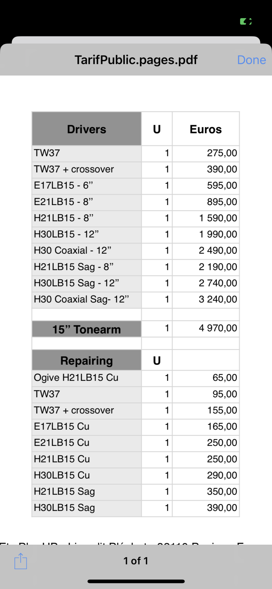

Hi Waxx,site is still up and says still operational: http://www.phy-hp.com/
I would contact them direct as it seems these days they mainly sell direct from site. But i know a guy in Belgium (not on diyaudio) that recently (a year ago or so) bought drivers from them and he was very happy with what he got. But call or mail them before to be sure.
I stand corrected. Impressive that they have not adjusted their prices since 2015...

Well, unfortunatly they only haven’t updated their website. Prices went up by a big margin I’m afraid and price/quality ratio dropped accordinglyHi Waxx,
