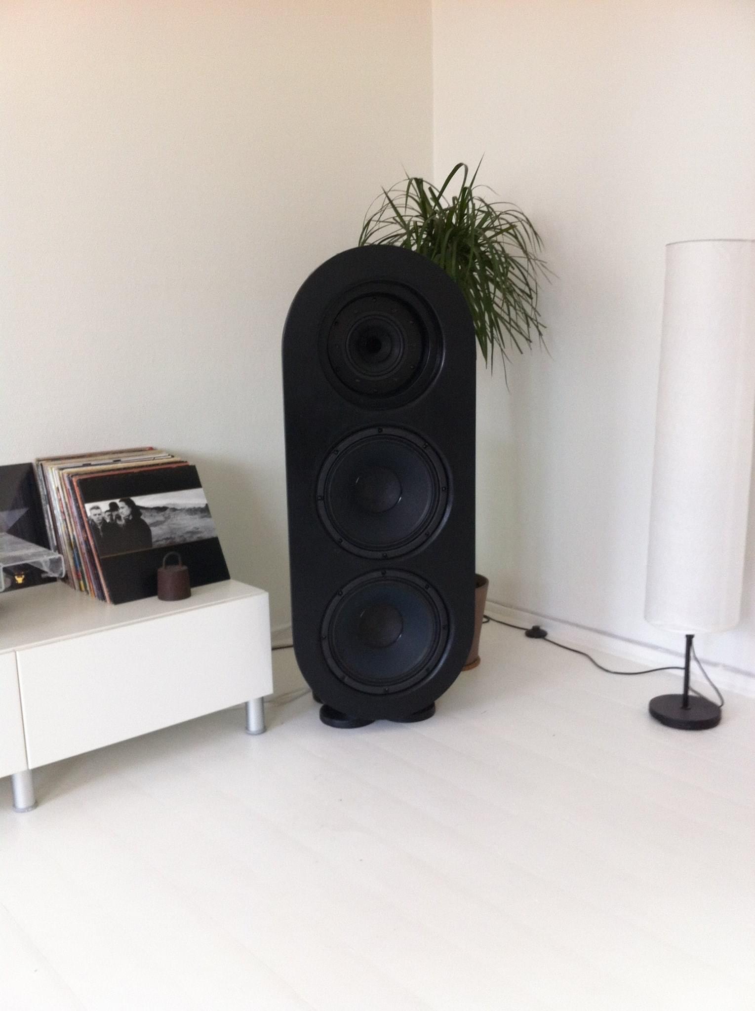

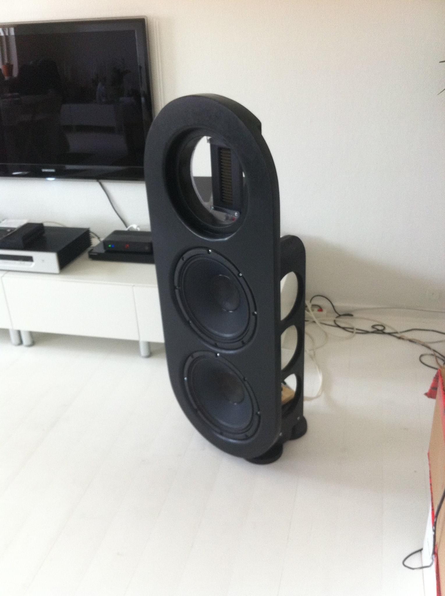

I started in 2015 a project with my now wife. She is good with tools and I stick with the computer, solderiron and the electroacoustics. We started with a Dayton AMT and 2x2 12” GPR drivers. The LF fitted our budget and the QTS/Fs was fine from a OB point but that was all about it.
We then got hand on 2x2 12” custom designed drivers and thay keep the wheel turning. We were happy with the result. The size and LF output was very good on our room. The sound reminded me of my dads ESS AMT-1b but with less hump in the low end.
