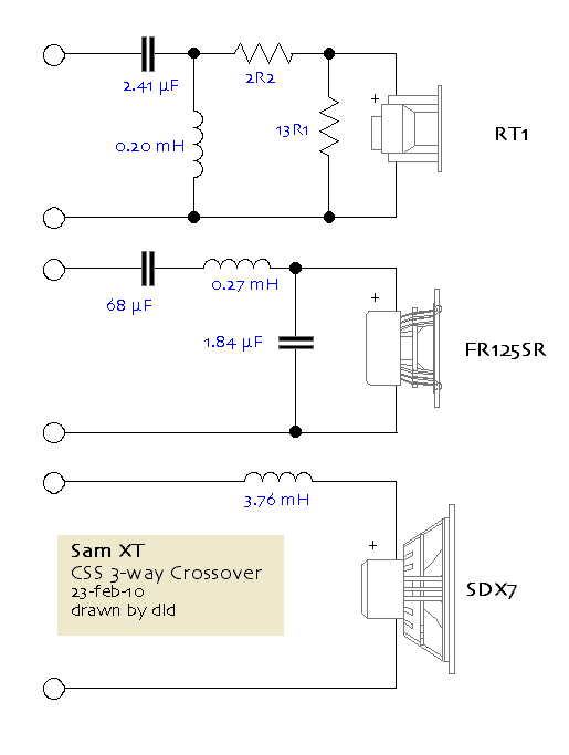

In post #20 you say you will try & get schematic up of the crossovers.
I am keen to see these as I am looking at a similar project myself with FR125 & SDX7 in same MTW format you have used & for all intense & purpose a similar baffle size. Am I copying you? No. The idea started life as a Focal Utopia look alike (which received good WAF results)

Schematic
Tim,
I'm trying to find the final crossover values I used. I believe the only difference from the one in the first post is that I changed the order of the high frequency crossover from a 2nd order to a 3rd or 4th. I'll try and dig up exactly what I did today for you.

Sam,
I'm gonna poke you for the promised XO schema & pictures🙂

The final crossover I'm using is as follows.
For the tweeter I went second order at 7200Hz. I used a 2.41 uF cap and a 0.20 mH inductor in the arrangement shown in the first schematic. (The attenuation resistors are also in there)
For the Mids low pass I used a second order low pass with a 0.27 mH inductor and a 1.84 uF cap. The high pass for the mid is a first order with a cap of 68 uF.
For the woofer I used a first order low pass with a 3.76 mH inductor.
So far I really like the way it sounds. The project I'm working on now it to bi amp them so that I can put more power to the SDX7 as they do sound a little strong on the high end.
Let me know if you have any other questions and I'll try to answer them a little faster.

Dave,
I never did do the cone treatment. I might have a try at it in the future but right now I'm working on another project that's taking up my time.
The XO you posted seems to be correct. I never put a zobel on the SDX7.

I did a similar setup tonight with a discontinued Tangband tweeter (part number not known at this point). Only first order on the midrange Low Pass though. Why did you go 2nd Order Sam? My setup sounds nice. Just two boxes piled up with tweeter sitting on top so far. 10 litre sealed for SDX7, 5.5 litre aperiodic for FR125. I tried ported on SDX7 but the bass was flabby. A better less sibilant tweeter is now something I need. Ideas?

My tweeter was crossed in at 4KHz first order ...so same drivers...slightly different x-over....values all approx. the same. 4mH coil on SDX7. 53uF and .28mH on FR125. I will have to try a 2nd order x-over some day. Sweet spot is bigger right?
