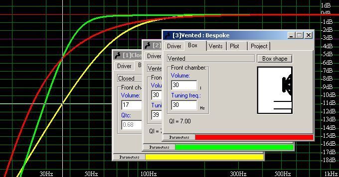

Thanks. That helps a lot. These SDX7 make lovely bass with a port but just don't have any ability to go very loud ported. Might try ported again for a small room application though. Not sure where these are going. You said slot at 27 Hz eh?

.75cft tuning to 28hz
For the SDX7 those have no problem playing all day long in those parameters.
And if you can like i said slot port. I switched all my designs to slotp ports many years ago. The cabinet designs unload completely different when you compare the same designs.
