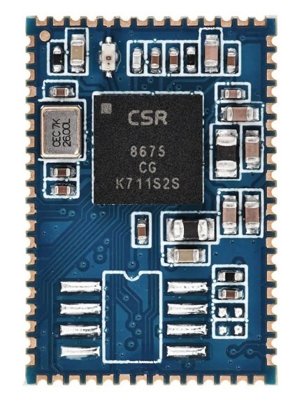

I have found out that it is possible to buy this modules on aliexpress:
BTM525 QCC5125 LDAC APTX-HD APTX-LL I2S IIS SPDIF bluetooth
Is it sufficient that I connect +3.3V power supply and spdif pin directly ?
The image is for CSR8675, but you're referring to QCC5125. Both are not recommended and will require at least connecting the antenna. Schematic example is here.Is it sufficient that I connect +3.3V power supply and spdif pin directly ?
Thanx,Schematic example is here.

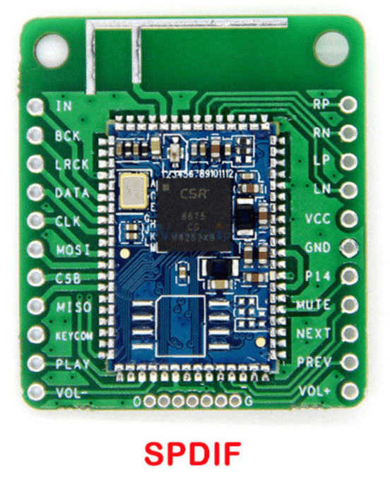

finally I have decided to buy this one:
/CSR8675 Bluetooth V5.0 Low Power Bluetooth Audio Module Receiver Board APTX-HD Lossless Compression I2S Fiber SPDIF/
It has antenna-like thing build in, so requirement of bt antenna should not be an issue anymore
Something that worries me is that LDAC is not present in aliexpress item description. Do I need to turn it on during programming ?
Very last thing : I'm curious if quality of sound from built-in dac after connecting via opamp to amplifier will be much worse than CSR8675 <-spdif-> DAC <-RCA-> configuration.
Simple answer: you will not get LDAC.Something that worries me is that LDAC is not present in aliexpress item description. Do I need to turn it on during programming ?
More complicated one: it's possible, but requires programming skill. You will spend years working on that (ask me how I know, tho I've worked with QCC51xx). There is absolutely no reason to work with CSR867x, it's already obsolete.
If you don't want to make you own PCB with antenna, you'll have to go for off-the-shelf boards, like this or this.

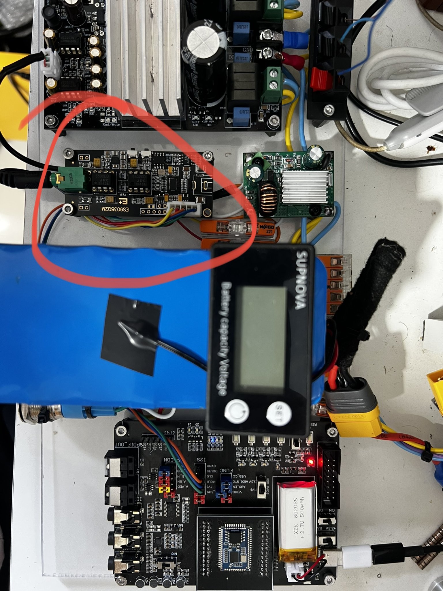

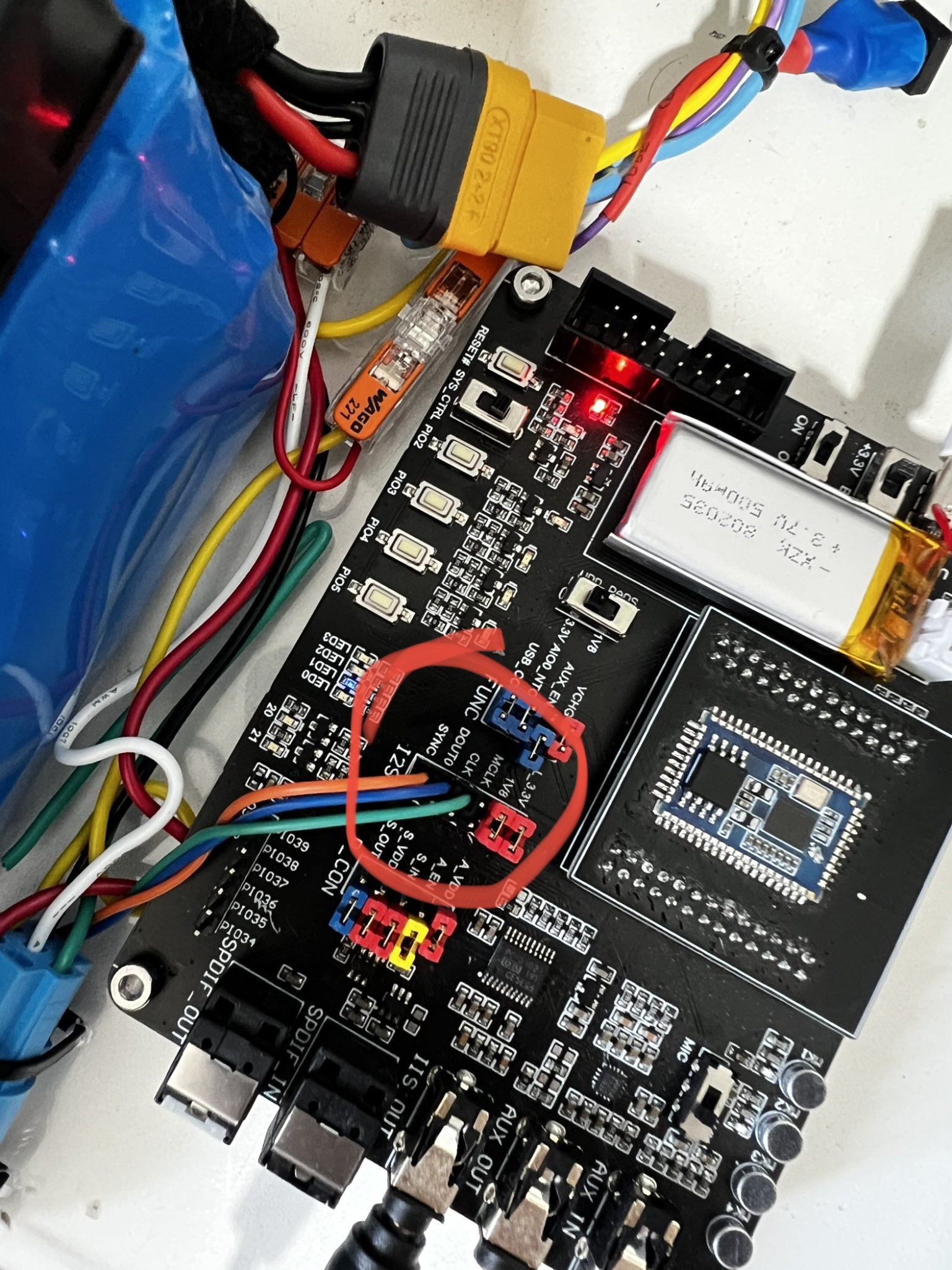

Anyone have integration with external dac? I'm trying set pios explaned in the board schamatic, but it isn't works, if i set the def INCLUDE_SSM2518_I2S_AMP gets panic.
subsys3_config2.htf
# Select PIOs for I2S interface 1: SCK, WS, MCLK, SD_OUT, SD_IN.
Pcm1PioConfig = [ 10 11 0F 12 13 ]
MCLK is not needed because my ES9038Q2M module has an independent clock of 100M
subsys3_config2.htf
@LOGICSB,
use PcmPioConfig (without 1, so it's for 0th I2S instance) and add ENABLE_I2S_OUTPUT define.
Is obviously not going to work unless you have SSM2518 as this define is mainly for I2C amp control (i.e. volume).INCLUDE_SSM2518_I2S_AMP
